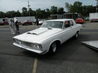

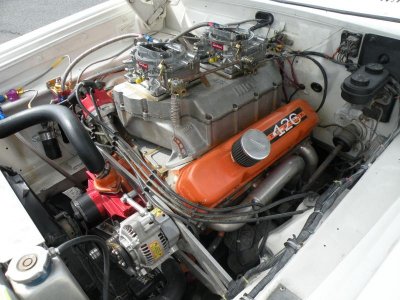

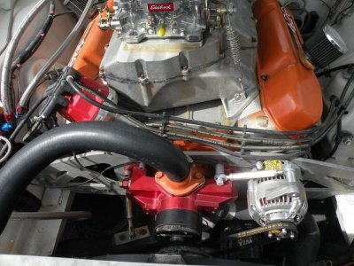

I have a Eagle Stroker rotating assembly in my 63 Plymouth for 9 years now with 0 issues.
Eagle crank, rods, with the good ARP 2000 bolts(this is the key) get the best rod bolts they make and make sure your engine builder make sure all clearances are correct. I make 735 hp in a 500 ci indy 440-1 headed motor with a MP Megablock and have run a best of 9.96 in a 3650 lb. savoy.
