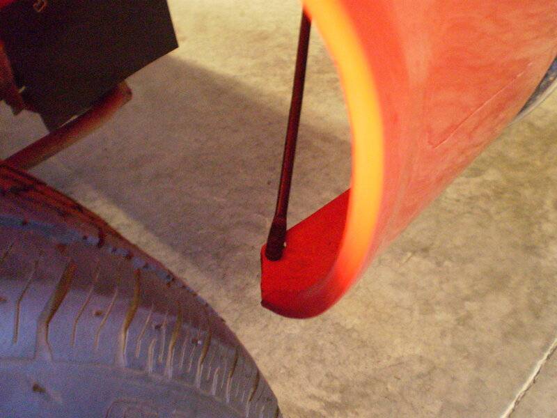

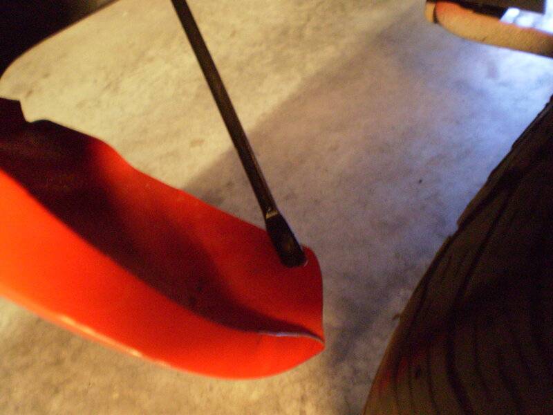

I have 215R70's on 15 X 7 rims on my 1964 Polara. Watch clearance at leading edge of front fender.

I had to trim the front corners of my fenders because they turn in so far. When turning, the tire would snag on this area. I was looking at a friend"s '62 Dart and it looked like he had more clearance here.

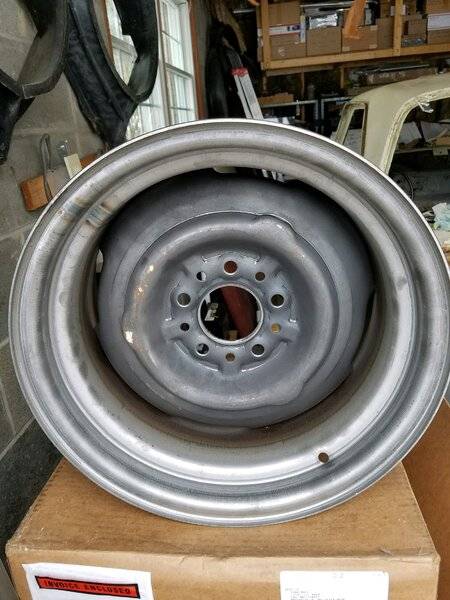

I have 235/70x15s on 15x6 factory steelies with 4" backspace. A little too big for the six inch wheel, and one side rubs on a header tube. If you don't have a header tube in the wheelwell, should be good.
