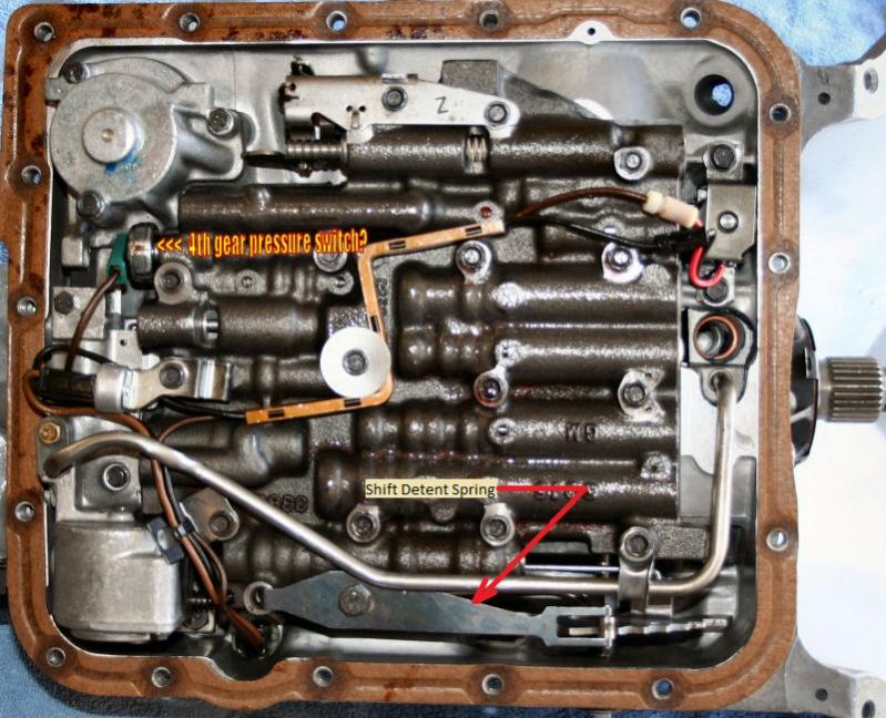

I put a 700R4 in my B-body for around $740. The nice thing about this trans is it is easier to fit into a Mopar than most other overdrives. I will be working on doing the same thing in a '56 Plymouth. I plan to use a "push-pull" industrial cable to shift it with the original push buttons. Check this out:
https://www.cccables.com/cables/pushpull.aspx
It will require that the detent spring on the trans be bent up to soften the shifting force, but it shouldn't be too difficult to do. I'm sure you could do something similar with your cable shifter.
