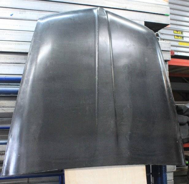

Why there is an untouched market for CF hoods. I built one for my 62 Lancer and it weighs 14 lbs.

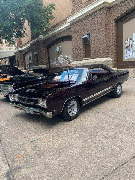

I put one on my 68 X back in 71. Owned the car for 48 yrs and always took off and put back on myself. A lot of guys grab thru the scoop. I never once did that for fear of damaging the relatively thin scoop glass. I always lifted from the front corners to sides and put it up on my vinyl top. Put it back on the same way. Wide stance balancing it on my waist buckle. Even to my late 60’s never posed a problem for me once you acquire the technique- but I’ve also no back issues. But I do have shoulder issues on both sides. As far as at the shows or just showing off - iron/steel pipe a member in San Diego made for me for $50 for the set of 4. Getting them set up on the pipes does require help tho. You’ll master it and they’re well worth the look et al….

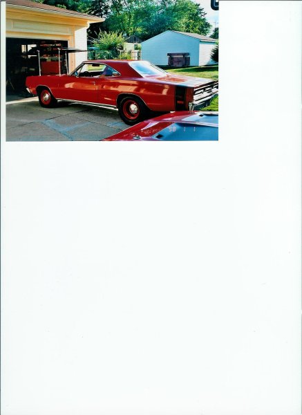

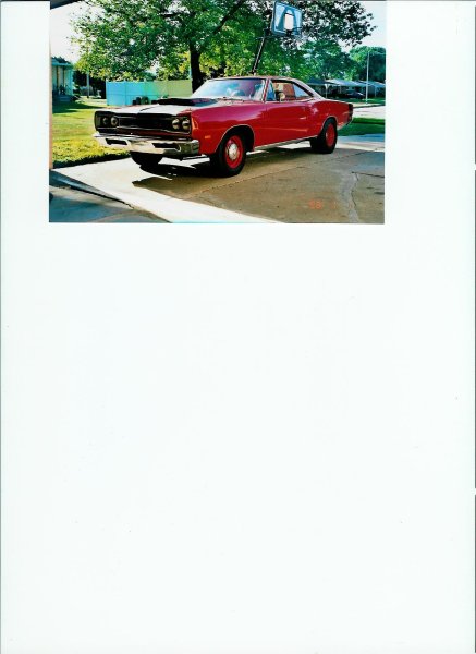

I never found it too difficult to lift off my hood and put it back on by myself. I also made some 1" dia clear acrylic rods to support the hood. I made them a little taller than most, so I could use them for working on it and for at cruise night or car shows. I would slip 4 extra hood clips through the clear rods into the car pins and use the lanyard clips on the hood to put in the top of the pins that had another set of hood pins threaded into the top of the rods. Even the strongest of winds couldn't blow it away.

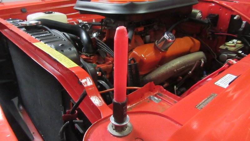

Regarding hood removal and installation:
Removal is very easy for me. It's the installation part that can cause possible damage if you're not careful.

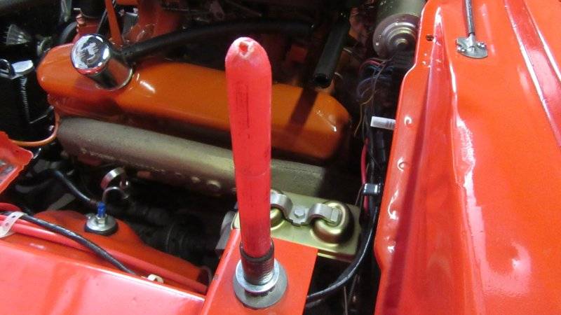

Here is what I did and it's been working for me for 7 years now. I call it the GPS guiding system :lol: I went to Home Depot and bought a 4 foot piece of plastic 1/2 inch PVC water pipe tubing. It's a cheap substitute for copper tubing. Anyway, I cut two 6" pieces for the back pins and two 4" pieces for the front pins. I used a propane torch to heat one end so that I can hand form a dome top on each one (see pics).
They slip right on the pins. When I install the hood, I lay the hood on the plastic "guiding" pins because there is no way I can be so precise to line up the hood pins to the holes. My fenders and/or cowl WILL get damaged without these make shift pieces. As it's resting on the red plastic pins, I can look to see where I am and I can gently move the hood where it needs to go. Once it drops down I simply pull all 4 plastic pins off and latch it with the factory cotter pins. See pics.
Hopefully I was clear about this. If anyone has any questions, please feel free to ask me.
Mike
Mike

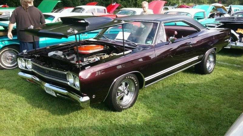

View attachment 1618770View attachment 1618772
Thanks for the input - very cool GTX.
Mike
Mike, the Red PVC helpers is an excellent idea. I can see your problem solving skills at work. Thanks......
