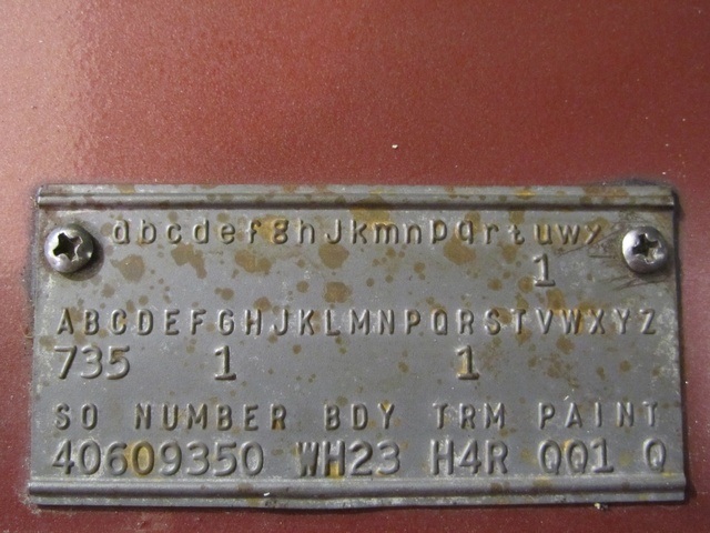

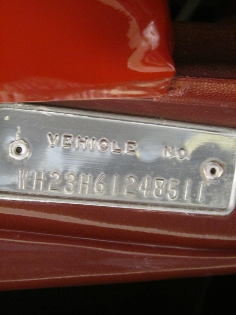

im not up to speed on 66's , but aren't these numbers supposed to match?
No VIN on tag in 66.
Those rivets on the tag are fishy. Don't think they should be there.
Vin WH is 440 model.
Some 66 cars were glued on and some were riveted, not sure any pattern though.
