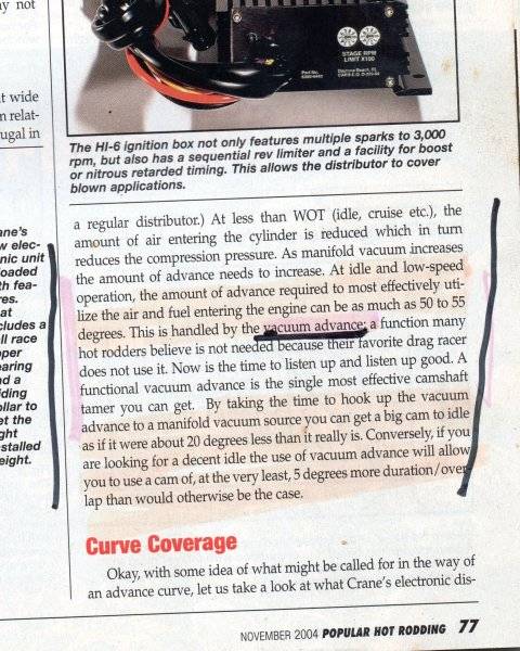

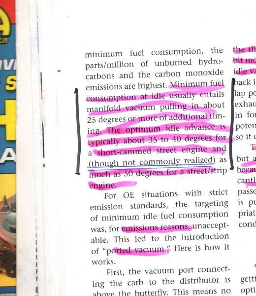

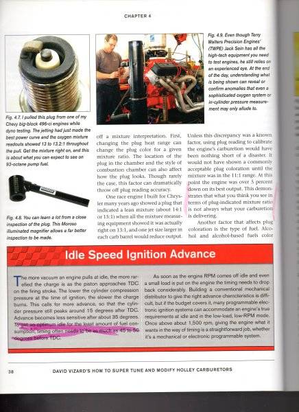

The starting point to fix this is idle ign timing.
Warm up engine, put in gear if auto, & engine idling, SLOWLY advance the dist until you get the highest rpm reading; just do it by ear. Then check & see what the timing is. Wouldn't surprise me if it was 40* with your combo. [ see below ]. Do NOT touch the carb for now. Report back & we can take the next step.

To answer some of the questions. I bought this carb new, and has been cleaned and rebuilt due to car sitting a few years. The jets are stock and metering rod are 2 steps richer, this was done when I was idling and driving on the transfer slot in the carb. I changed the metering springs per Geoff2's reply in another thread, now the rods stay seated. Timing is at 26* at 850 rpm. I worked on the carb last night and it will idle with the choke on, but as soon as the choke opens up it dies. I turned the idle screws out to 8 turns doing 1/2 turn at a time. No change. I'm trying to get this motor to idle off of the idle circuit, so the jets and rods should not affect anything. Am I correct in thinking this way?
Geoff2 - Thanks for posting the article. I was looking for it, as I had seen it in the past. That is the next step to try.

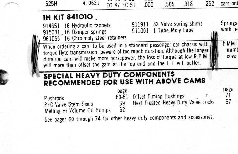

The main culprit is the cam. The 383/400 Ch engine has the highest rod/stroke ratio of all the popular BB engines. In laymans terms, they do not tolerate cams with a lot of overlap; they lose low end tq & idle rough. This is the reason [ below ] for the warning from Erson cams. The R/S ratio of the 400 is even higher than the 440, making the problem worse.
Also, the 800 cfm is a bad choice. A 650 AVS would have been better & more responsive in the low/mid range.
If it was my engine, I would replace the cam with an Isky 264 Mega. The low comp ratio is the big killer here & limiting choices. Fine tuning of the ign & carb will still be needed, but a lot easier.
If you decide to keep the existing cam, then the starting procedure is as outlined in post #12. Engine will need a LOT of timing at idle & you do that with manifold connected vac adv. See below

Again, thank you for the articles. The cam choice was because I was looking at the Hughes Whiplash cam which was suppose to help a low C/R engine. At the time, Hughes cam was out of stock and the Thumper cam had almost the same specs ( more lift on the whiplash). So that is why I went with it. The stealth heads were bought because they are 80cc closed chamber heads (that look stock) compared to the ~90 CC 452s. Also at the time 915 heads were going from 750 to 1,000 a set, then need rebuilt. So why not go with the lighter head. The 800 cfm Edelbrock was bought because I had seen where the Thermoquad was 830 CFM, I have put a 600 Holly on it and there was no change. The Mopar distributor and performer intake was off of a 400 I bought and had machined for a 451 stroker motor. I am going to work on the timing to see what it does. Future plans are, I am going to finish the stroker motor or buy KB240 pistons to up the C/R in the current 400. I'm just trying to get this car drivable for the remainder of the summer/fall. Please note that all this was done in 2012 and a lot has changed since then.
The Crapper cams, the Whiptrash cams, the Bootcrapper cams.....they all work on the same 'principle': lots of overlap, created by excessive exh duration & tight LSA. The exh valve opens early & you get as very noisy cackling exh note to attract the girls. The rough idle, poor low speed tq.....well you just have to live with it...
I agree with the cam not turning out like I wanted. A cam change will be done regardless what motor I do, as I am going to a roller cam.
I did work on the car yesterday and messed with the timing until my timing light quit working. I put the idle mixture back to the Eddy starting point of 2 1/2 turns out and adjusted the idle speed screw to get 800 rpm at 26* with vacuum advance unhooked. I advanced the timing and the idle increased to 1050 rpm taking little steps at a time. I ended up at 42* at idle and the motor never sounded this smooth. When I hooked the vacuum advance up to manifold vacuum it would go to 58*. At this setting the car still would flat out die when putting it in gear. When trying to start the car it was having a hard time turning over and my battery went dead. So battery is on the charger and I'm looking for a good new timing light.
If it dies when putting into gear you will need to have a higher idle speed. so end up up with about 850-950 once in gear, everyone else is right get the timing sorted before you start on the Carb
So it sounds like 42* is the magic number for idle timing for this engine [ see below ].
Sooooo, with this newfound knowledge, I would do this:
- set initial static to 20* [ not 26 ].
- use an adj vac adv unit & connect it to a manifold vac port. [ Buy a new dist if needed with an adj VA unit ]
- adjust the Allen Key [ AK ] in the VA unit fully CW.
- start engine & check/set static timing & then connect VA; between 40 & 44 is ok [ static + VA ]. If more than 44*, you need to make a stop or limiter for the VA actuator arm to limit travel to 22-24*.
- make sure timing is steady with VA connected.
- come back after this is done for the next step.
