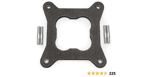

if its not the choke or the fuel pressure......perhaps you need an insulated spacer underneath your carburetor? iv seen carbs absorb so much heat from the intake manifold that a person could not hold their hand on the carb. that condition will cause surging and stalling. good luck.

I recently did that under my AVS2 and now the carb stays cool to the touch. Edelbrock #9266 for dual plane.
Does it matter which one I get? I have the Edelbrock 1406 with an aluminum intake.

I ordered the Edelbrock 9265 carb spacer. I hope it works. Plus some good news. My buddy hit the cable end with the welder and it made a slag BB on the end. I'm hoping it works. I'll order another one as back-up.

Depends on your intake. If you have a normal dual plane I'd get the one on the left, if you have an Air Gap RPM style or single plane, I'd go for the right.
Ah, I went with the one on the right. It matched the carb gasket.
