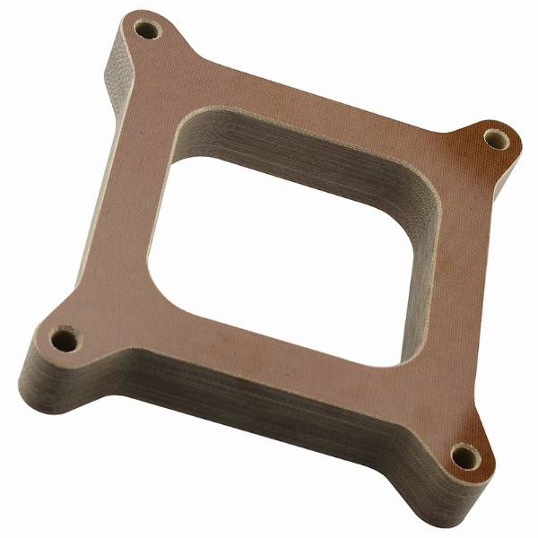

I am in the process of upgrading my 383 two barrel to a four barrel. I've replaced the intake with the correct factory intake and am putting the carburetor on this weekend. I went with the Edelbrock 1906 as recommended by a number of people on here. My question is on the spacer. I am going to need a spacer as I have a little clearance issue (need about a 1/2"). What are people running with this set up? I don't know the mechanical implications of using a different thickness spacer, which is the bases of my question. Any suggestions would be appreciated.
You could get a phenolic spacer.
Got it. Outside of hood clearance issues does the thickness matter?

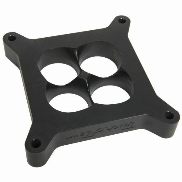

If the intake is a dual plane, I would use a two or four hole spacer.
If single plane, use an open spacer.
Idea is to preserve the intentions of the manifold maker.
