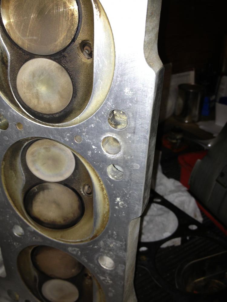

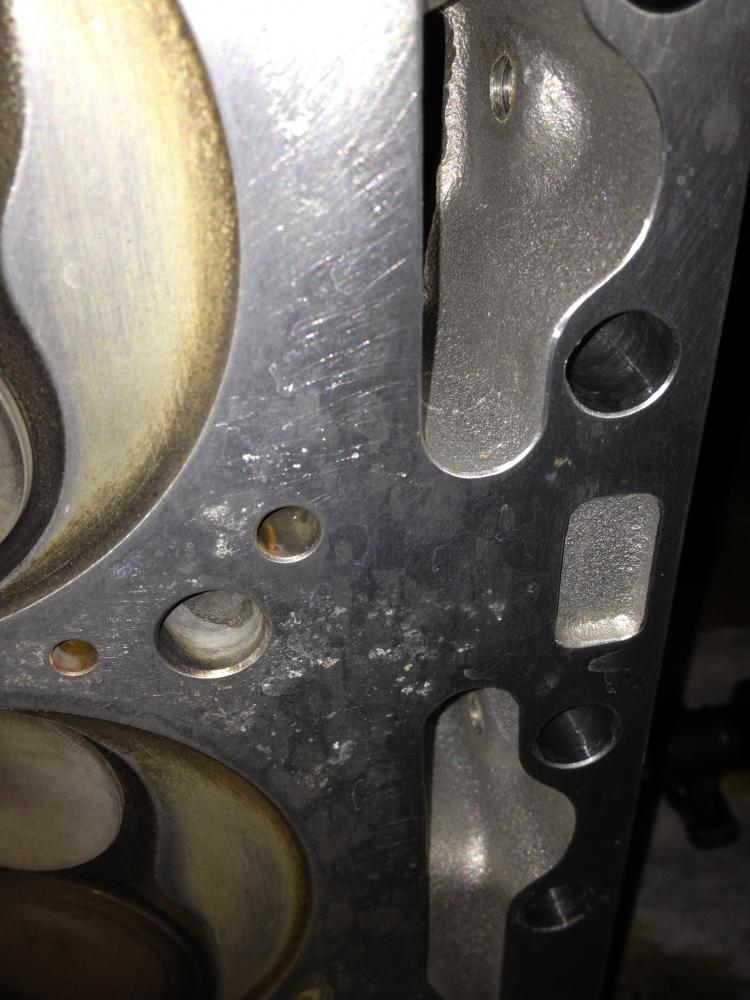

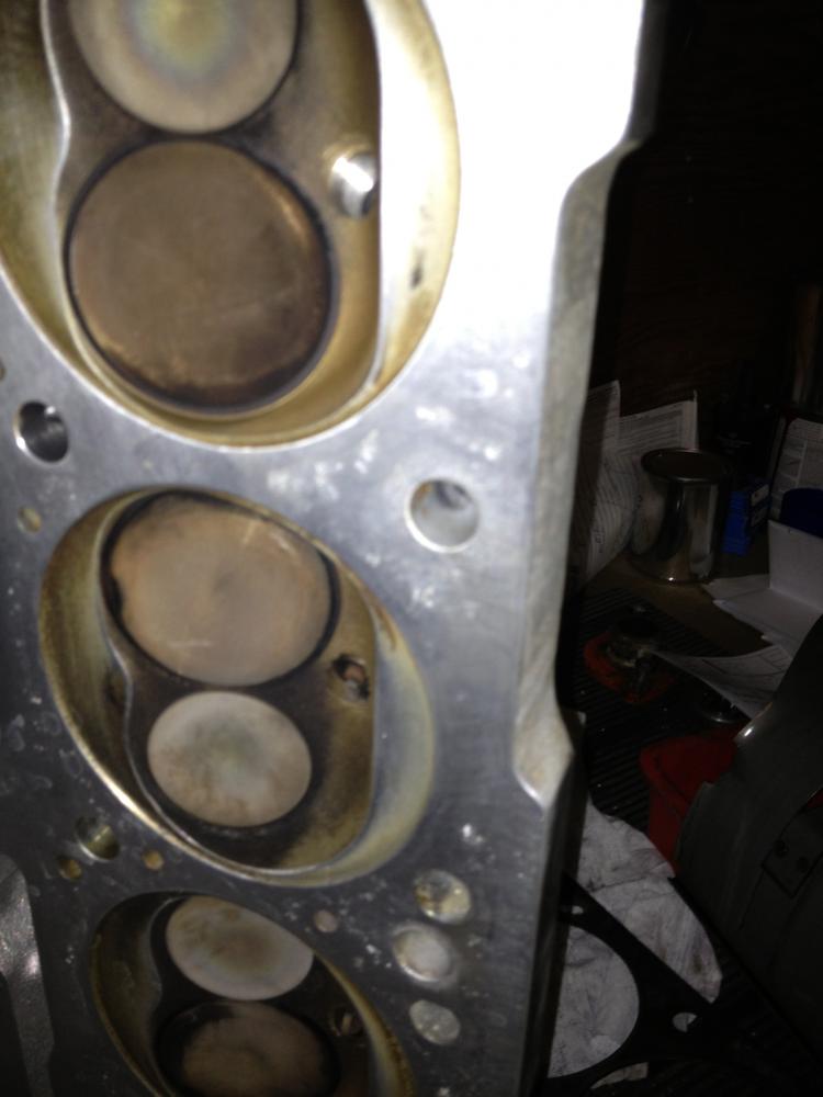

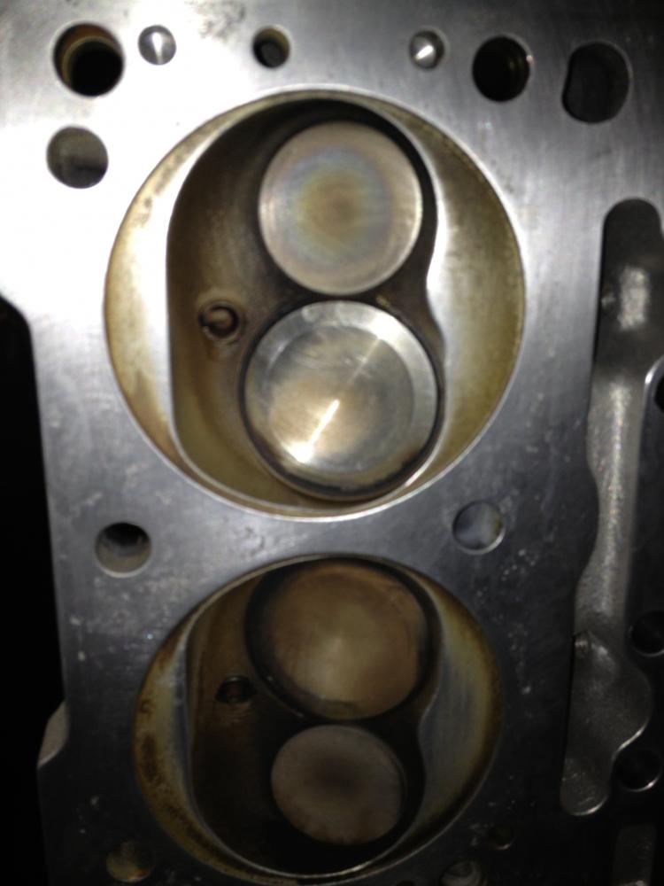

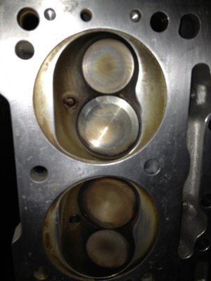

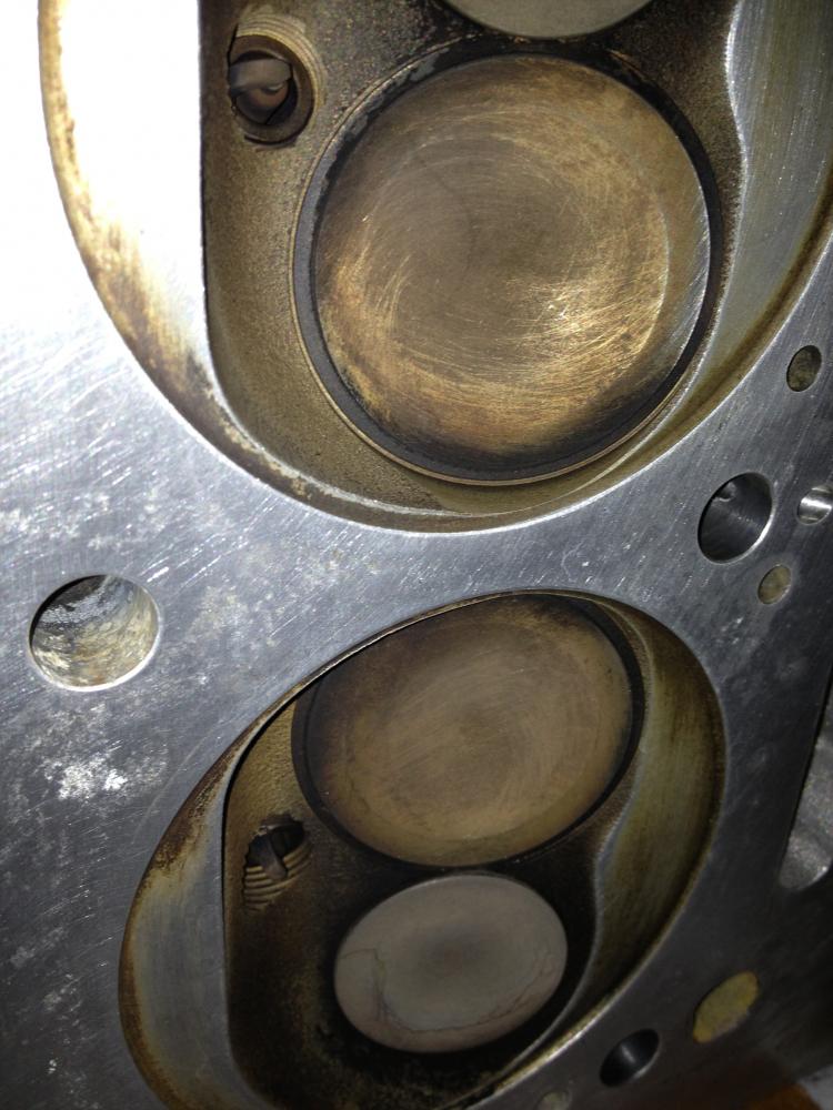

pulled my heads of to regasket motor and the heads have some tinny little corrosion pits, do i need to resurface these ? or can i just bolt them back up , dont want to raise comp so kinda leary about resurfacing.. i phone jan 2013 096.jpgi phone jan 2013 097.jpgi phone jan 2013 098.jpgi phone jan 2013 099.jpgi phone jan 2013 100.jpg
Did you blow a head gasket? Just about anytime I have the heads off a car I will run them to the machine shop to have them checked for straightness and a light surface. Especially aluminum heads that have more of a tendency to warp. Just something I've always done. Seems like cheap insurance.
No blown gasket , just that we only have one machine shop here and they are very pricey , and they kinda have the attitude it needs to be done weather it's needed or not
if they are big enough to catch your fingernail on,then yes resurface.
definetly feels like a blown head gasket or water leak, why else would there be corrosion there? i have heard some people use coppercote on the gasket maybe try that when reinstalling
