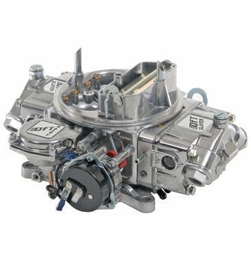

is it a manual trans or automatic trans ??, how many mods have been done to the 383ci engines ??, what is your expectations ??, what is the intended use ??, I would suggest to use a between a 600cfm up-to about a 780cfm on a mostly stock type engine depending on what driving conditions ??, what altitude you live at ??, is it strictly a daily driver type, a hot street car or a Street/strip car ??, if it's the daily driver, then the smaller the carb, would be probably better for mileage & all around drivability... If it's more of a hot street car then a little bigger maybe middle of the road 680-700cfm, if it's a little more modified like headers, cam, intake & hot ignition, street/strip car then toward the top end of the 750-780ish/cfm... The formula/guideline for carburetor size; Cubic Inches X Rpm, divided by 3456 = total cfm example; 383 Ci's X 5500 Rpm div. by 3456 = 609cfm... that's at about an 80% efficiency ratio of useable fuel... I like Quickfuel carbs {but just my preferences} a SL-600-VS with electric choke would be about the @ beginning point {about $300, depending on where you buy} & up-to the maybe the 4160 Holley 770cfm Street Avenger with Vacuum Secondary & electric choke {about $350 depending on where you buy} or an old style tried & true 750cfm #3310 Holley would work very well also... If it's has a manual transmission you could use a double pumper, but there's also nothing wrong with a good vacuum secondary carb, especially on a car that is or will mostly be street driven, the secondaries only open if you need them, not just because you mashed down on the throttle, like on a Double Pumper... I've also seen many 750cfm Holley style carbs on mostly stock 383ci's run very well...... I hope some of this helped you...

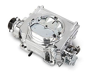

That new "Street Demon" is 625cfm w/vac. sec. w/electric choke & is a "spread bore" design carburetor, with smaller primaries larger secondaries... I've never ran one, probably never will either, my type builds are generally way above that level of a carb anyway... but I would really like to see what someone who has ran one, who knows what they are talking about, actually thinks of/about them...
  • Demon 'Street Demon' 625cfm Spread Bore Polished Vac. Sec. Elect. Choke 4bbl #333-1902.jpg
