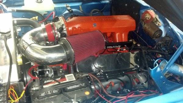

The Edelbrock XFI manifold that I am using has a large single blade throttle body mounted on the front of the manifold and really not much room to direct fit a filter, so it has a few 4" elbow and tube length going to a K&N cone type filter.

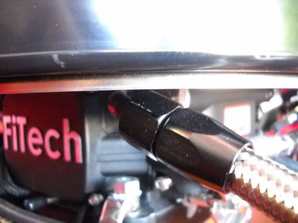

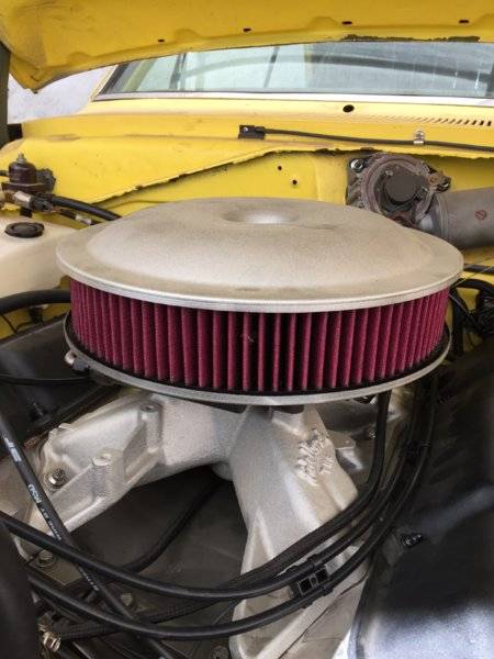

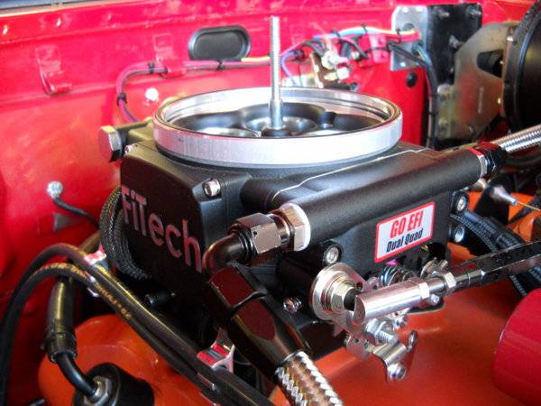

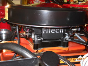

I use the FiTech units. A standard 5.125" 4 barrel based air cleaner fits fine. A dropped base will work if you need more hood clearance, but I needed a 1/2" spacer with my drop bases to clear the fuel inlets.

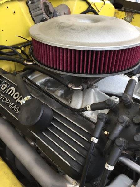

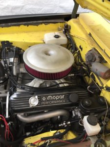

Holley Terminator set up. Don’t mind the terminal showing, changing wires to Accel Extreme 9001C, they have ceramic boots so I won’t burn through them anymore.
DF0A0421-6EE1-46C1-A746-DA75DA50AF78.jpeg BB361328-7CA9-4502-9205-7AD959BB48B1.jpeg 9A418835-DF8D-4ED7-BA76-015BEEE8F256.jpeg

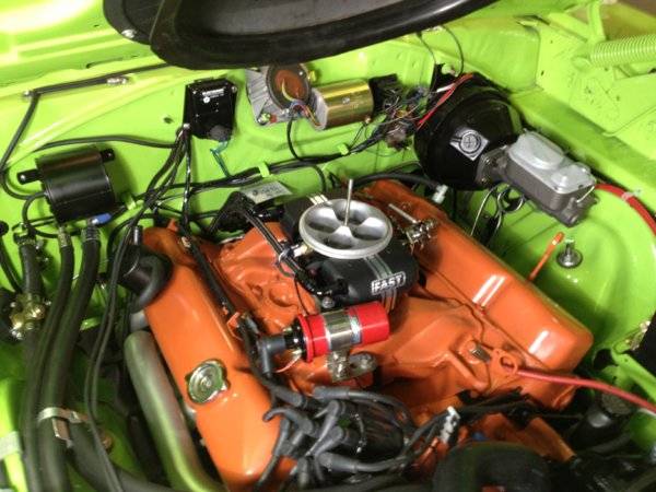

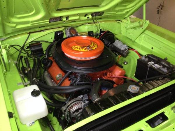

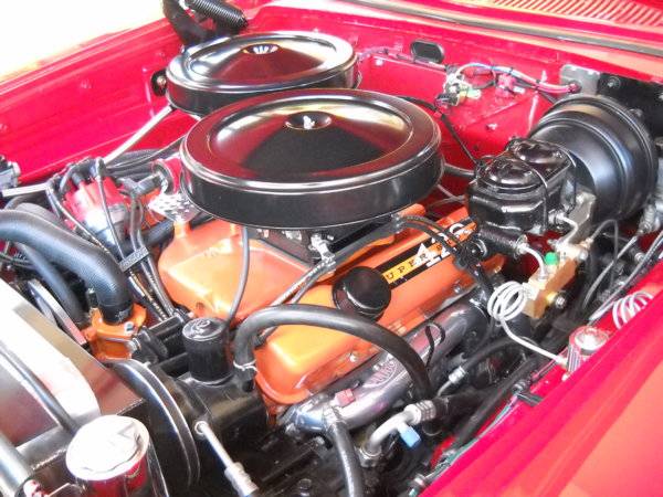

I installed a FAST throttle body system. I hid the installation as much as possible, and with an Air Grabber, I used the original air cleaner and base...
How does that system run now Hawk? I know you initially had issues, but has it settled down now? And do you need to run a diagnostic tool across the system periodically, or is it just drive and enjoy?

Hi Kiwi,
Yes, I had problems initially with my system. FAST said it was my wiring and forced me to run around trying all kinds of difficult crap. I finally had to prove to them it was a faulty ECU. When they sent me another, my car instantly started working fine. So, FAST tech support SUCKS!
However, I have to say the system itself has been flawless once I got the working ECU. No fuss, no BS, no worries. It starts and runs in any weather, it idles perfect, with or without the A/C running, etc. When I drove it across country it was perfect, regardless if I was at sea level or at ~14,000 feet (Pike's Peak). There is a screen that can read codes, run diagnostics and also adjust parameters in the ECU for timing, etc. But there is no need to run any diagnostics unless there is a problem. So far, so good - just drive and enjoy!!!

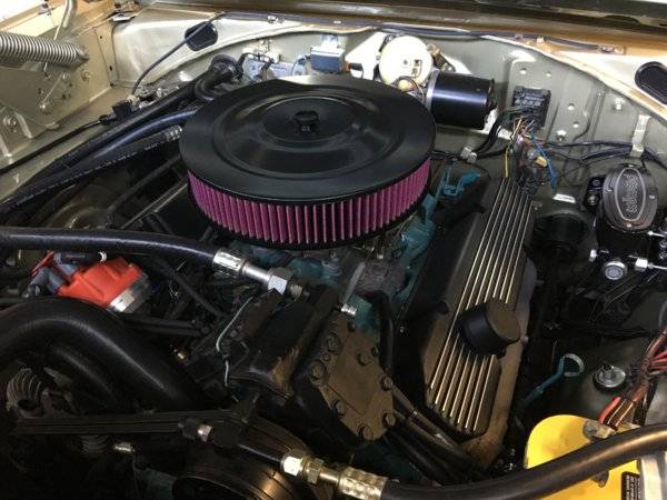

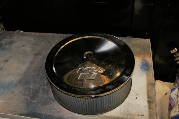

i used a summit racing one: SUM-239434B $40. it is 14inch in diameter
it sits atop an MSD Atomic EFI. i tried a few different drop base ones but could not figure it.

I built my car very carefully and I spent the whole winter integrating components into my harness and under my dash. My specific issue was that I had an early ECU with noise issues. FAST fixed this with later ECUs. However, when I was calling them with my issues, they CONTINUALLY blamed my wiring (and made me make a bunch of changes that were very difficult to make under the dash). They never asked about the build date of my ECU. Even when I discovered the early ECU issues through an internet search, they pretty much refused to acknowledge the issue. I finally forced them to send my another ECU (which they made me pay for). When I plugged in the replacement ECU the system INSTANTLY started working properly. So my experience was not good with their tech support. On the other hand, as stated, the system has been flawless since that time. I am very happy with the way the car runs and drives.

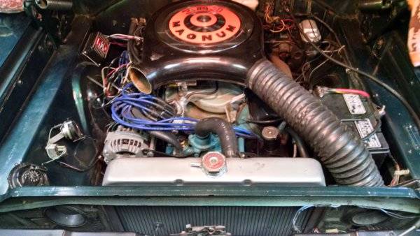

I run a ram air box, I've had it since 2000. First with a carb and more recently with MSD Atomic EFI.
With the Atomic you can really see the difference on the inlet air temp. When I first installed the Atomic I quickly
tossed on an extra air cleaner from my truck and drove it 15-20 minutes. It was a75 degree day and inlet air temp was between 90-100 degrees as it took air from under the hood. With the ram air box it gets close to ambient as you drive down the highway. The only tough part is how to route the hoses to get outside air without having it look crappy or cutting holes in the core support which is what I did. My Charger is really just a driver, it was a New York car years ago so it has rust underneath.
Since I have a 22" radiator I had a little room to cut in the 4" tubes. But 3" would probably be plenty large enough.
