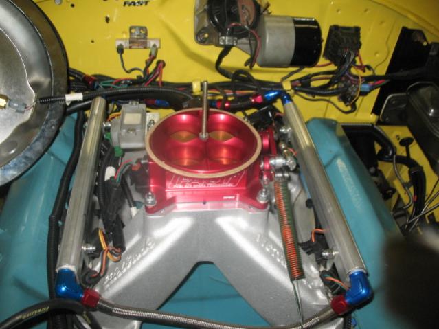

496 stroker EFI purchased as with the following..... Fast 302000 multiport kit ,307603 throttle body with iac tps and tps harness,307502 600hp fuel pump kit, 307030 fuel regulator, Victor efi manifold,E-brock fuel rails and Holley 522-428 injectors rated for 670 hp. GM part #,s : 1 bar map 16137039,coolant temp 25036979, air temp 25037334.GM parts found on mid 90,s LT1,s.Iac and tps is GM as well. Lots of hood clearance with this setup
Require a good charging system as upgraded the alternator for 14.0 volts at idle.
