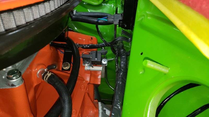

Interesting, would have to think about it. The timer parts are cheap, requires an original or repo six-pack choke spring assembly and a later heated Thermoquad type choke spring, and a bit of time. Could be spendy however. Will gauge the interest level.

Yes, it’s my experience as well that with headers or manifolds without a functional heat riser valve and open crossover ports/stock heads, the stock choke will operate acceptably with what heat that does make it up through to the choke well. Issue is, with blocked cross-overs and/or aftermarket heads without cross-over passages, there will be no heat for “as-designed” choke operation with original choke parts. The merging of later electrical assisted choke springs allows for more normal operation and appearance when no crossover heat is available.
With this set-up, the choke spring is fully relaxed in about 4-6 mins, the timer/resistor releases the relay at about 8 mins to reduce the current flow to around 500-600 ma, from around 1.7 amps the heating element draws when at full voltage.
To be clear, I’m not planning to go into business making these things, I have a few folks interested so far in what I’ve done to solve the problem for my cars/projects. If I can assist a few others here, I will as time permits. The biggest expense will be the two choke spring assemblies needed.
