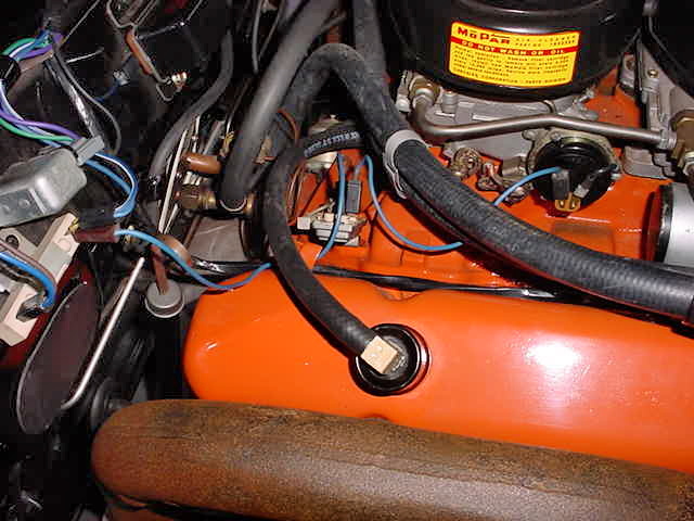

would it be a problem using the pos side of coil to hook to the electric choke.i have electronic ignition and my ballast resistor has 13v going in and 13v coming out.
instructions say don't do it...
(put it on a fused circuit.... otherwise if it shorted out, there wouldn't be anything stopping it from cooking)
Right here.
blue wire from ballast or blue wire to regulator. Not the blue one at ballast going to the coil which is spliced into a brown wire up to 69, the blue side of ballast with dual blue wire. This is the RUN circuit
since 70, the electronic charging system got an extra blue wire runing to alternator field, which becomes also on the source for it, being the same RUN circuit ( coil + lead wire become on brown since 70 )
