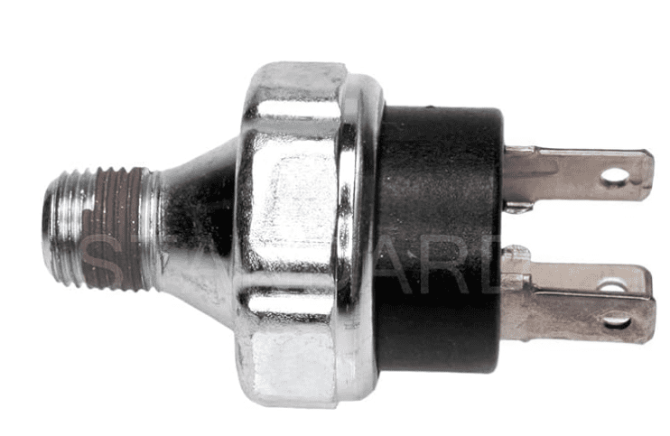

Anyone have an accurate part number aftermarket, for the oil pressure switch, with the extra circuit for electric choke, hook up , Thanks in advance, JC

Curious what does this type of switch do? Provide power or ground for the electric choke on the carb when the engine is running?

The center spade triggers a ground for the light. The outer two are for an electric choke. Power to one spade and the choke on the other.
