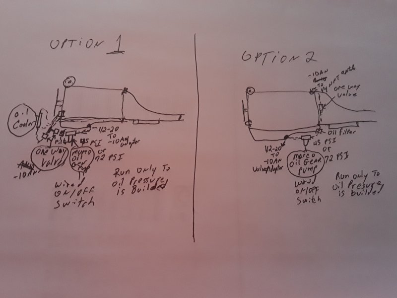

My design of the system I want to try is below,
Do anyone is a flaw in my thoughts of the system.

Only flaw I see is its unnecessary.
Do a poll of how many guys on here use an accumulator on anything other than an 800hp drag engine.
Is the OP an engineer?

More work to make your rig than pulling dist.
How to pull and put back your distributor to prime engine.
1. Pull cap, take picture so you can see where rotor is pointing.
2. Clean base of distributor and block in a place you can reach. Take a 1/4" wide 1" or so, put the so it goes from base to block.
3. Slice the tape between distributor base and block so one piece of tape stays with distributor and one to the block. This is so when you put distributor back in you align the tape up so your timing is the same as before.
4. Remove distributor. Take a picture of your distributor drive so when you put it back it is in the same position. Prime your engine! 5. Put your distributor drive back in where it was.
If you need to move it use a large screwdriver turning it CCW until it is where it was before.
6. Put your distributor back in with rotor as in was before. ALIGN tape so your timing is as it was.
If you turn the engine at all you'll go through the BS because of turning engine.
Then there is nothing to be concerned about with the clicking of the valves until the hydraulic lifters pump themselves by up.
Cost wise is about the same as the accusump system.
Was worried about hurting the cam on the startups.

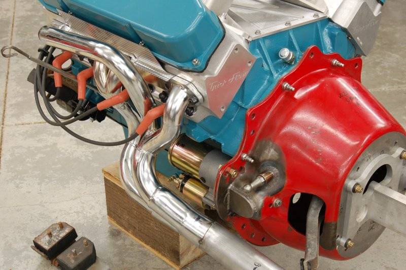

I installed an accumulator on my car a long time ago. I have it wired into the ignition system with a switch so I can turn it on or off. I flip the switch on before cranking the engine so it has 25 or 30 psi and then I hit the starter. It takes some effort to install but I like having one.
Did you plum the pressure in/out hose via a oil pressure plug on the top back of the motor or a oil filter sandwich plate?
Engine block has a large port above the bellhousing that feeds the main gallery. That is where the Accusump is connected.
