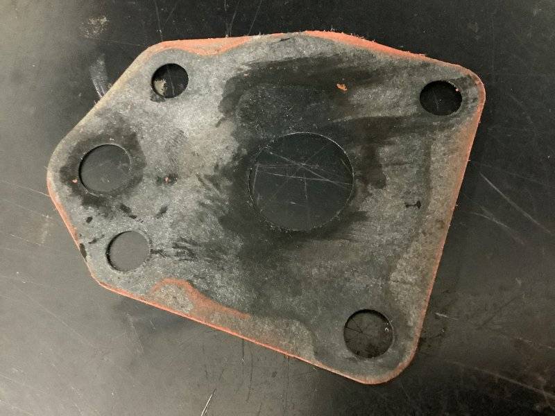

Here is the culprit, the gasket was indeed missing the critical hole for the oil pickup port. What a **** show…

can't you just put a hole in the gasket where it belongs?

Nobody local stocks a big block oil pump gasket, I’m going to cut the one I have and put everything back together. I’ll be sure to post the final outcome…
Edit because I'm dumb lol. Gasket goes between block and pump. Full size cut or the cut you did should be good.

It fits the port perfectly. I smeared some tacky red chassis grease on the pump side and stuck it to the pump. Right now the pump is in place but one of the bolts is awol. Once it turns up I can torque the pump down, reinstall the filter and spin it with the prelube tool. I’m feeling pretty confident that it is going to work...

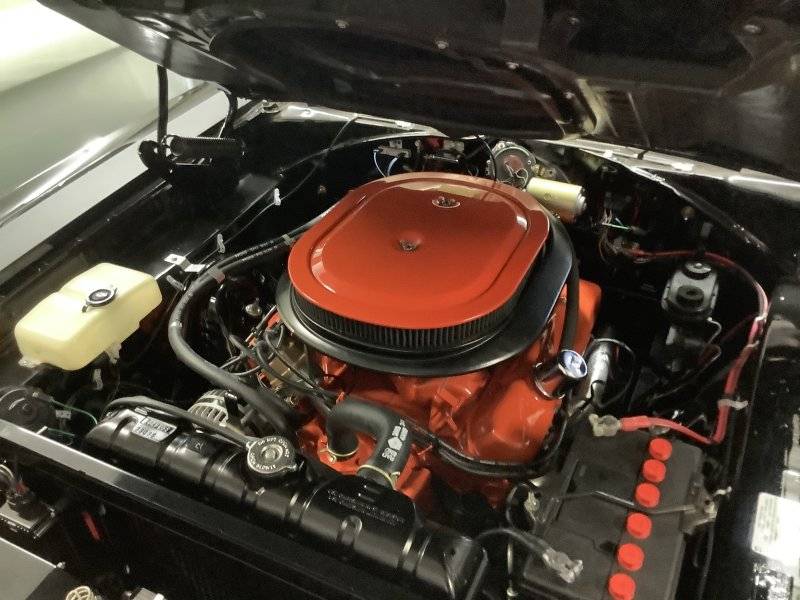

When I spun the prelube tool for about 5 seconds there was a lot of resistance. I had Mrs. Black_Sheep watch the oil light and spun it again, it went out instantly. I bolted the PS pump back on and dropped the distributor back in place. It fired right up. After setting the timing and adjusting the idle rpm I let it run up to temperature. No leaks, coolant temp stayed at 170 F and it isn’t making any strange noises.
I’m going to call it a victory!

This shows the importance of posting pictures, as the culprit was staring at all of us in your first pic.
