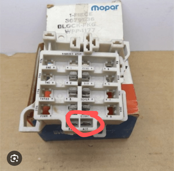

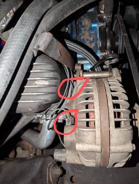

I've read about using a wire off the alternator, one side of the ballast or using the acc on the fuse block.
What's the best option? What connector would I use with either the alternator wire or ballast wire?
Appyany advice!
I would advise against tying it into the ignition. It w
ould be just as easy to run a wire from the ACC terminal to it under the hood.

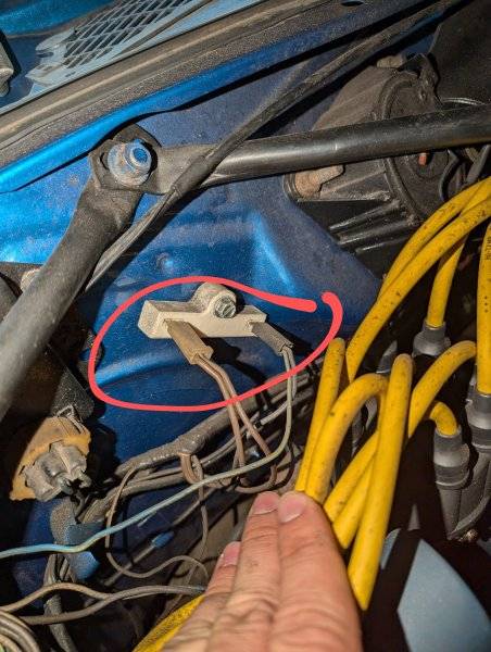

Factory Service Manual shows the electric choke gets power from " SWITCHED RUN" voltage. Easiest place to pick that up in the engine bay is at the input side of the ballast resistor.

Double Blue wire side of ballast resistor for HOT side of choke. Ground wire can simply be run to carb top screw.
EZ connection, input side of the ballast resistor...

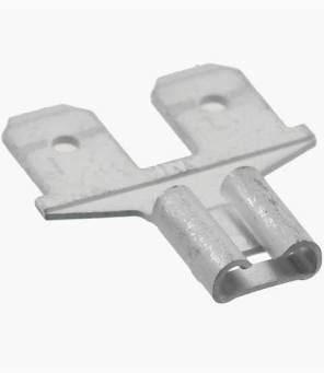

Get one of these from Napa or Amazon...

Assuming an aftermarket carb with electric choke. 1973 was the first year for factory electrically assisted choke systems, won’t find it in the ’72 FSM. As mentioned, ignition 1 is the correct circuit to tap into. Dark blue wires in the engine harness. Can access them at the ballast resistor, dark blue alternator field wired, and the voltage regulator. Common too, there could be an extra lead on the harness for an idle solenoid. The fuse box tap is Accessory, don’t really want the choke heating up in acc.
