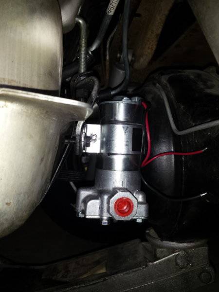

I only have a 3/8" fuel line. My pump is mounted right above & to the side of the differential. I know this is "uphill", but it allowed me to keep the tank/pump line short & protect the pump with the frame. If you have dual exhaust all the way out the back, there's really no room inside the frame rails.

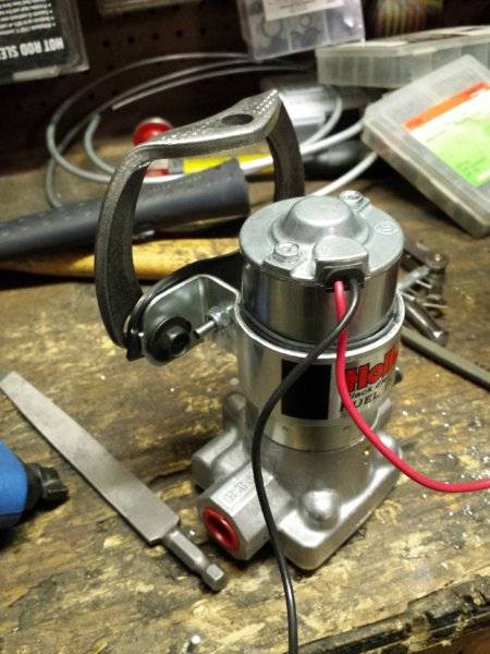

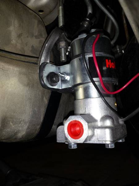

Here is my redneck pump mount made from an exhaust coupler. It is bent and mounts to the pass side fuel tank bracket bolt. Puts it in the correct spot and low enough for siphon effect to take place...

Mine is pretty much in the same location as threewood's. I used a steel cable instead of a bracket, so even more redneck. Ha.
As for the wire, I ran it along the frame and connected to the coil.
