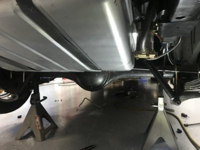

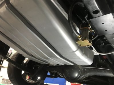

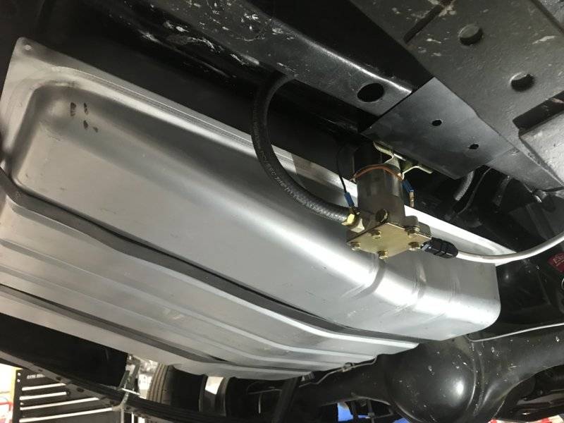

I have a electric Holley fuel pump pusher style, when I put the tank and the fuel pump in the car and pump worked good, but had a couple of fuel leaks and evently ran out of gas, now I’ve fixed all the leaks and the tank has 10 gallons of fuel in it. the pump kicks on but no fuel is getting pumped, i unhooked the main supply line to the pump and there’s no fuel coming out of the tank no matter how the hose is positioned, it takes no effort to siphoned gas out of the tank(yuk) I currently don’t have a fuel cap and the tank has none of the vents hooked up just open. Does it have to have that pressure to flow? And do I need to get a vacuum pump and pull the gas to the pump to get the fuel started

I’m using a new factory fuel tank and pickup/level. There’s rubber fuel line going from the tank to the pump and aluminum line going from the fuel pump by the tank to the regulator under the hood, then rubber coming from the regulator to the carb. And I verified several times that in side marked in is coming from the tank and the side marked out is going to the carb. I thought to I might not have it mounted low enough I had metering part of the pump below the fuel pump, so I unhooked the pump from where it was mounted and set it on a milk crate where the pump was 2 inches below the tank just to troubleshoot the problem still nothing, when I unhooked the rubber line coming from the tank gas was not coming out even though there’s 10 gallons of gas in it, shouldn’t this line be gravity Feed and have fuel coming out of it? The pictures have the fuel pump still high I moved it down more after the pictures

I don't think that big loop de loop you have in that line now is helping things.
I agree with the big loop statement. That line from the tank should always be at, or below the outlet on the tank. Also, if you ran the pump for any length of time without fuel, it's possibly burned up.

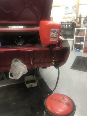

The pump is toast. I unhooked it from the tank and hooked it to a gas can and turned it upside down and it worked for maybe a second and wouldn’t pick anything up after that
If you weren't getting fuel to it it probably burnt up ( rotor)
If you can't get a warranty replacement they're rebuildable. Its just removing the bottom plate I believe, as long as the motor runs.
Agree with Daves69. If the vanes are stuck, it won't pump. That's why I love gerotor pumps. I've got a Mallory 250 that's at least ten years old and works great.
Holley pump vanes do stick. That's the major reason I went to the gerotor style Mallory pump. Take the pump out, take the bottom cover off, see if the vanes are in place & if a couple want to fall out, they should move freely in the slot. Remove & clean as needed. The pump does need to be below the tank!!
