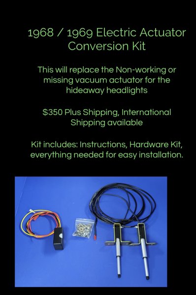

I installed Herb’s electric conversion kit on mine. Here’s one that costs a little less money.
