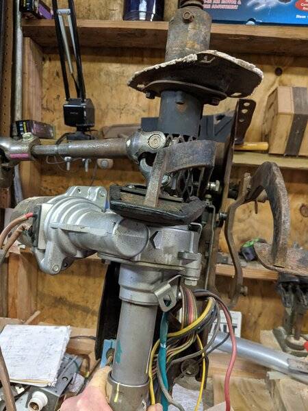

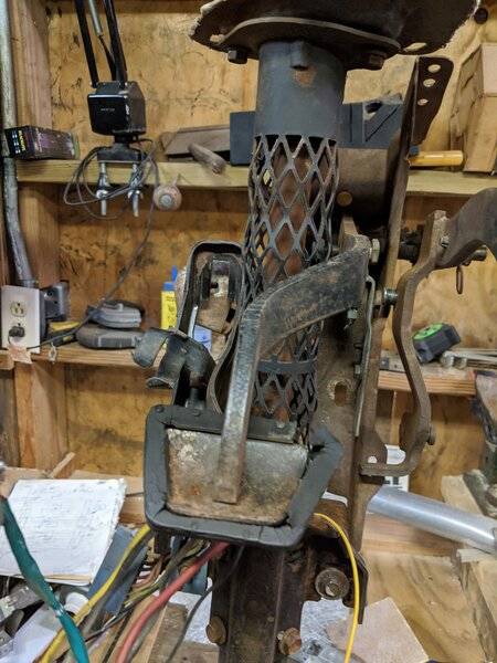

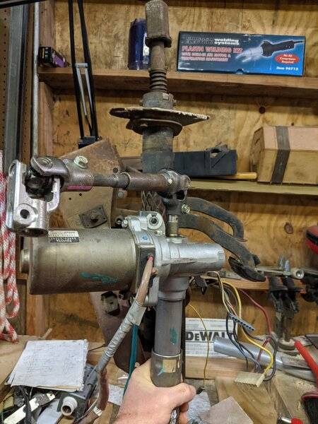

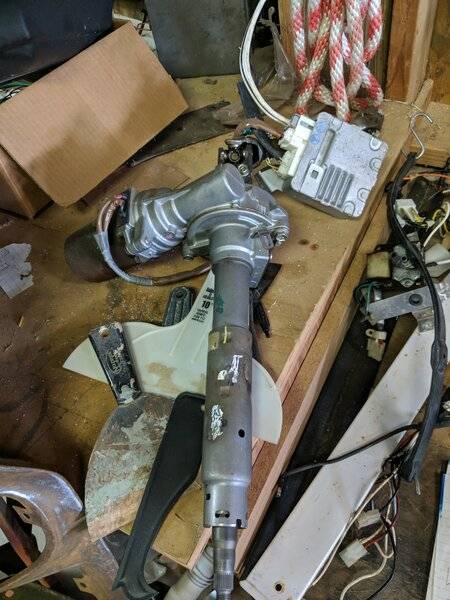

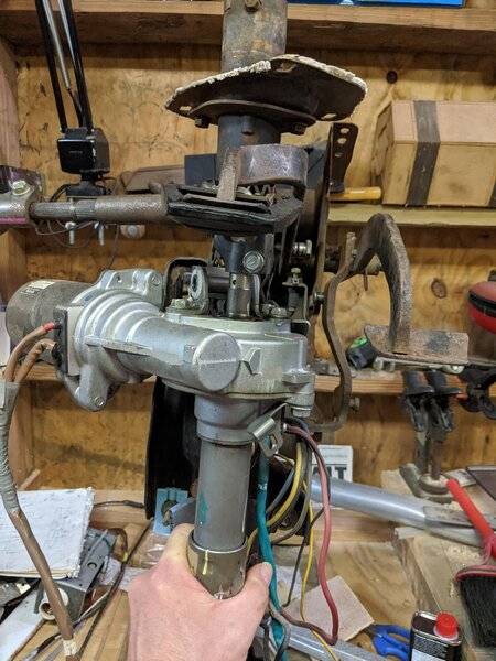

I'm just gathering parts for this project like usual it'll probably take forever but I stopped by pull a part so far and I have a spare steering column from a wrecked 72 parts car with the crushed sleeve bent and the shaft.
Anyway here's a mock-up to look at.
Holding up to where it would fit nicely in the crush tube it is going to hit the brake pedal. So it looks like I'm going to need to move it forward to clear the brake pedal which means cutting into the steering bracket.
That's about as far as I've gotten on this project. IMG_20210327_210834.jpg IMG_20210327_210745.jpg
