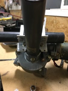

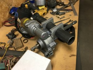

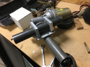

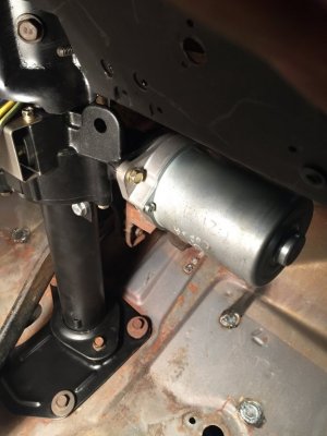

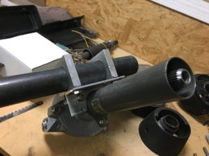

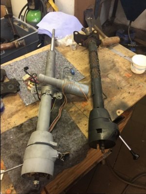

I have quite similar looking column with electric power steering in my Camaro, with rack&pinion. Works nicely. Total cost with used column around 200-300$, not noisy at all.
I used Opel Corsa C column. Don´t know why, but that´s very popular here in Finland in retrofit use (mostly in rallycars). Pretty simple to wire also, only thing is, that originally vehicle speed affects how much steering is powered, so you need to generate speed pulse to it. Common thing to do is use ->

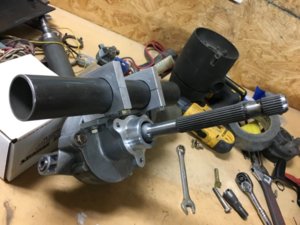

One of my friends and I have been building a vehicle for quite some time and it was our intention to use one of these column assist units if we got to old to deal with the manual steering. We design a steering system that we believed would be low effort in the manual condition. By design it has long steering arms a 16:1 rack ratio, a nice rolling scrub radius and a large diameter steering wheel. All good for easy steering wheel efforts, but I still couldn't to use one of those little manual racks, so we made our own. We utilized a rack shaft and pinion from Woodward Steering so the parts are replaceable if they wear. Please forgive the rust and dust it's been sitting for awhile.
Most of the OEM electric power racks don't lend themselves to packaging in anything other than an east-west application, large SUV's or Pick-ups. In my opinion the column assist systems are not robust enough in your application for the aforementioned reasons. So in my opinion, by default, a hydraulic steering rack would be your best choice. If you don't have room to package the pump you can always use an EHPS pump.........................But that's another discussion!
