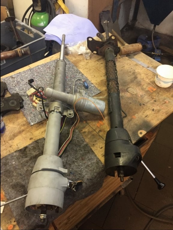

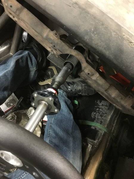

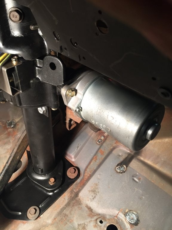

Finished!
So how does it work??
It works!!! Because my car is in restomod I can't try the power steering while driving.
I tested the power steering controller I've bought at www.rallywiz.com. I've contacted them and asked if it was possible to connect the PSC with the speedosensor hooked up. They told me it will start in midrange model.
Here's the video:
It steers very light. Remember the engine and trans aren't in de car.
In the future I would like to change the ratio to 16:1 by rebuilding the steering box and deleting the play, as you can see in the video.

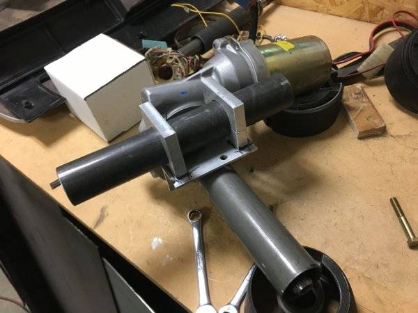

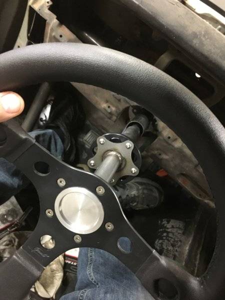

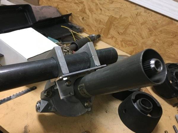

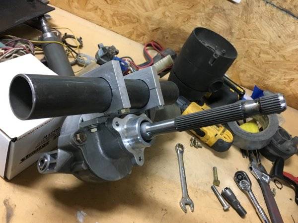

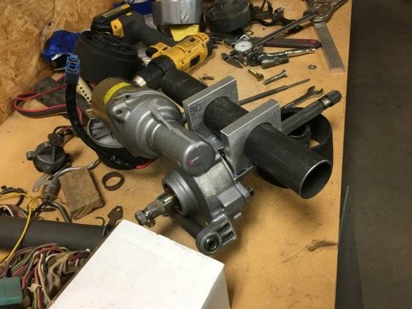

I ended up with a Saturn Vue assist motor and column assembly off ebay. I’ve figured out a mounting plan but need a few more pieces. It’s a much larger and more robust looking unit than I had anticipated but should work fine.

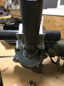

So.....luckily, my dash bar going across the front of the car was in exactly the right position for this steering motor to work. I ended up making an aluminum clamp type mount. The motor will actually pivot on the bar to allow my tilt to work. Now I need to tackle the telescoping column clamp.
Looks great! How are you going to control it?
