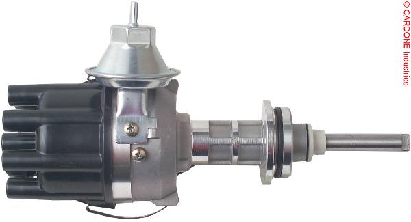

Anyone had experience with the cheap Cardone Select (new, not refurbished) Mopar distributors?
https://www.cardone.com/Products/Pr...lectronic+Ignition:::Supplied+w/Cap+and+Rotor
Have used one for years with no problems. Make sure everything works, is hocked up and adjusted before installation. Do not know about the new ones.
I'd like to hear from folks who have used the Cardone as well.
My GTX came with a new (at the time) Mopar Performance conversion kit and I've been fighting "scatter" at 4500RPM or so with it ever since. Replacing the orange controller with a store-bought unit changed absolutely nothing, better or worse.
I can't even run the vacuum advance on the MP distributor without the thing getting all jittery/wonky on me.
Since my 440 is pretty much stock, I'd think the Cardone would work?

Try replacing the magnetic pickup in the distributor you have first your symptom is typical for it being bad and a small price as compared to replacing the distributor.
Really? I always thought those were one of those electrical things that either worked or didn't?
