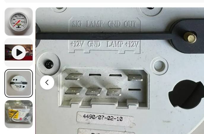

Found this on ebay also....

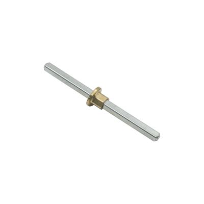

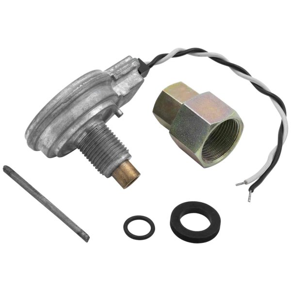

I installed an AutoMeter electronic speedo a few years ago. I had to use a sender, like the one pictured, to make it work with my car's original A904. Did you make sure to install the little square rod? If you left that out, you can do everything else right, and it still won't work.
BTW - I really like the gauge. It's dead accurate and easy to recalibrate if you change gear ratio or tire size. It's also compatible with the factory Tremec sender. When I did my TKX upgrade, it was plug-and-play.
