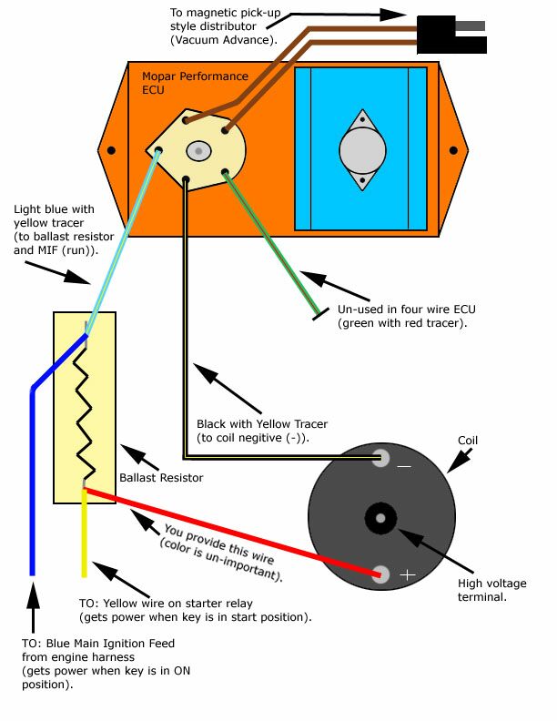

You should be looking into the ballast resistor and how its wired. You show only 2 wires going to the ballast resistor. One from the ECU and the other going out to the coil. You should have a run wire and a start wire there on the ballast resistor as well.
mopar_4pin_ign-jpg.1715240699

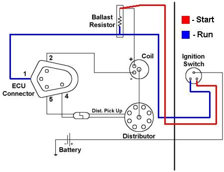

Or
So I tried your first diagram because I'm getting rid of the starter relay, and I have a 4 pin ECU. I still have no spark. I don't know if it's the switch I bought tonight but I don't understand why it's not sparking. I can get some pictures tomorrow of all the connections if need be.
Or
