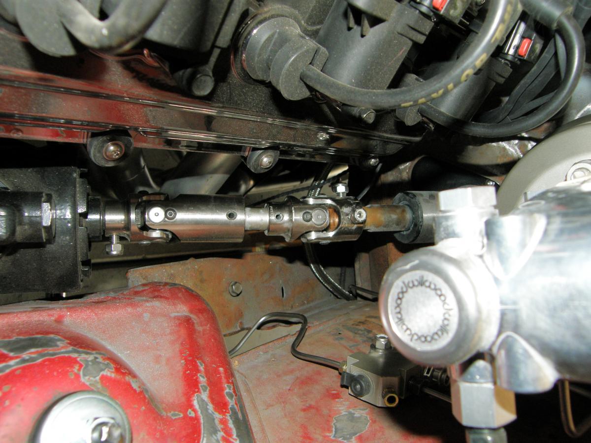

i ended up dishing the money out for the flaming river steering shaft coupler. worked well and elimintated the whole rag joint and coupler. steering does feel better and it is safe and very efficient. straight shaft all the way to the box. no play at all in steering wheel. very little vibration in wheel. just a tad more then before. will post pics when i get home for the weekend from work.

got any pics yet?

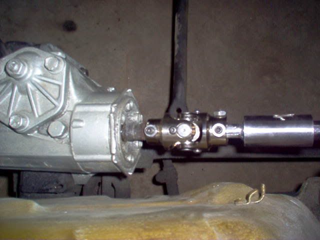

Here is what I did, this was for power steering and a Ididit steering column.

My concern with using a U joint on a power box is the absence of axial movement - at least it appears as such. There is a reason why MoPar spent the time to make the shoe type coupler function the way it did, and the reason is to allow axial movement of the steering box shaft. If you rock the splined shaft on the power box back and forth you will notice it moves in and out as well. I don't see where the U joint will allow for that. You might be able to get away with it on a manual box because it has no control valve.
