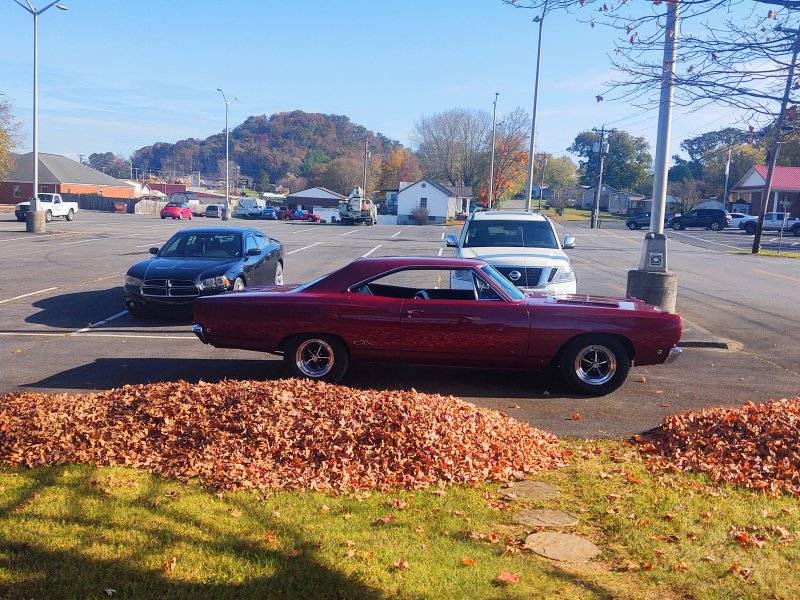

Finally, the more I look at them, the more I like choosing to mount them white letters IN - it's in keeping with Fred's
decidedly grouchy/sans gingerbread nature, methinks.
I hate to be "that guy" that's so picky and brings his car back, complaining....but this time, turns out I was right to do so.
Fred looks proper from 20 feet away, eh? :)
