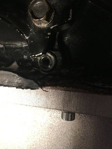

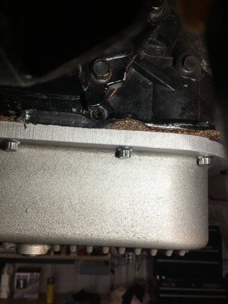

1974 727B where tailshaft housing bolts onto tranny,there is an empty threaded hole,almost looks like a barrel washer that moves in and out. What is it for?(see pics) 787BC5E8-76B0-4491-8624-34C58DA114BD.jpeg
That is the pin for the rear servo. It has 2 O-rings to prevent leaks, and is retained by the tailshaft housing...
Any pics on how it’s supposed to look? Trans seems to work ok just chasing some leaks- thanks
That is the way it looks, exposed to air.

Thanks guys thought I had an issue.Getting her ready to cruise on boardwalk at OC next weekend
If that pin leaks it can be sealed. Press it in as until it bottoms. Clean with brakleen. Use a putty knife to fill the cavity with a good quality RTV.
