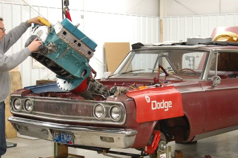

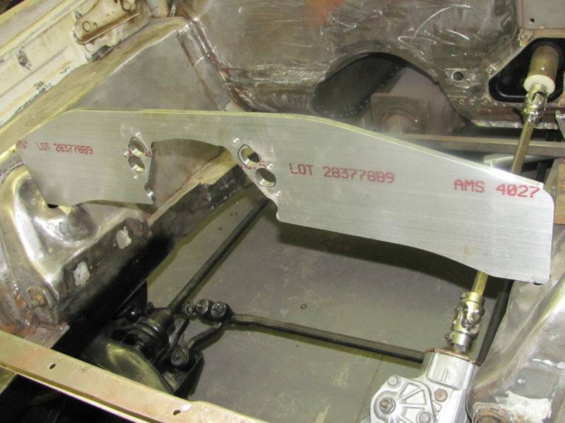

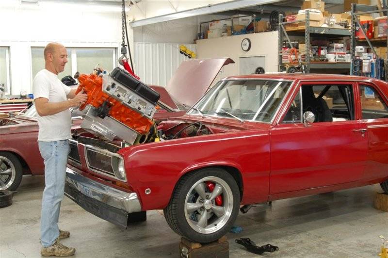

Beautiful Valiant. I really like the boxy styling. Don't see many around, or even for sale.I use a tilt plate on the carb pad. Makes the job super easy, especially if you have an overhead crane in your shop.View attachment 631846

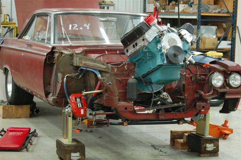

I pulled/replaced a poly 318 from a 64, no trans. The crane was right against the front bumper, what a pain.

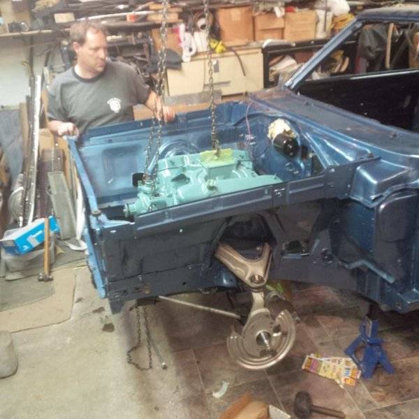

To do the headers, once the engine was in, motor mounts loose, car on stands, I used the crane to pick the engine up one side at a time.
No jack under the car leaves room.

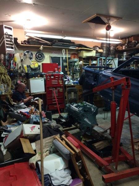

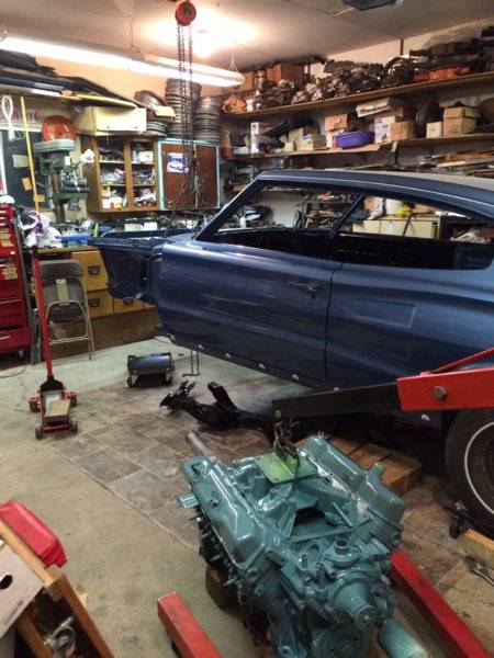

I've done motor/trans in one shot from above on an a-body and it was not easy, by myself. The shifter was in the way the entire time, but I didn't want to put it on under the car.
This time, with a bb/4 speed I think I'll put the engine in with the bell/clutch on it, and install trans/shifter from below.

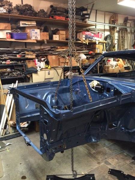

........Was really, really tight as we couldn't get the angle we needed with the leveler/setup we had and had to remove the engine mounts to get it over the line. Next time I will install individually...…...
No, we had the front end of the car raised for ground clearance of the output shaft on the ground. I had to remove the engine mounts for the extra clearance needed then it slotted in nicely.Were you just lifting the back end of the car to cut down the engine/trans angle? The main issue I have with my Abody is a deep oil pan to K-member clearance. (FW headers BTW)
