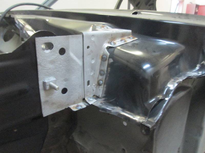

Hi guys need little help installing complete front clip on 70 charger.i have noticed AMD front clip is wider 1/2 from original one.i am talking about where the inner fender sits.so I can't square the inside the hood frame.is it possible if any one can give me the measurement near the firewall and near radiator support.i need near the firefirewall because I replaced new one cuz was badly rusted and was not on the proper place.

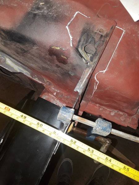

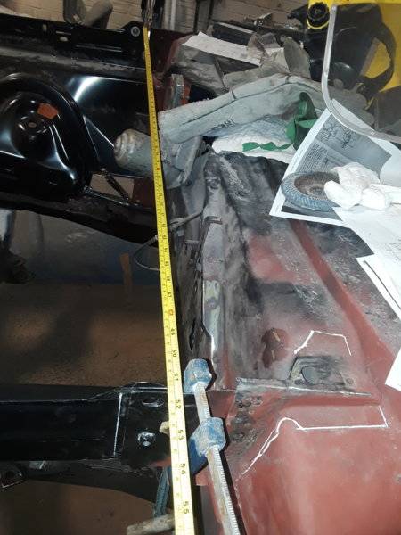

Well car is on level. And i.have complete front end with frame and inner fender installed .Compare from AMD from the original one AMD front radiator support is wider .that one I know it need alteration so that's not a big deal. Just need measurement hinge bracket to the other bracket .other alignment I will do like I did the front frames.

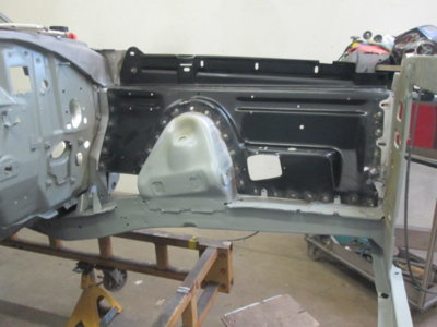

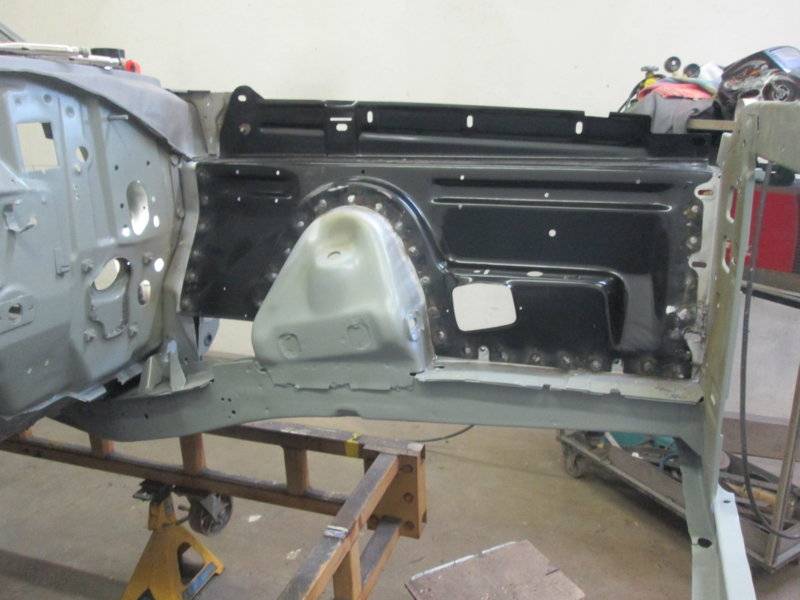

Compare it to your hood in matching locations and give yourself ~ 3/16" gap for each side. The hood "hole" is NOT square! Don't see how you can get the inner fenders wrong at the firewall end. They attach to the firewall extensions and locate to the upper cowl tabs. Inners in first on the old cowl first, then remove the cowl if it was necessary and transfer the "tabs". Location can't change that way.

Wow Thanks for explanation that make big sense will do that first . Thanks again

Thanks a lot :) yes I will update you guy's.first I want to fix driver side frame that is 1/2 short from one side angle next to rocker panel .what do you guys prefer to fill the 1/2 gap?
