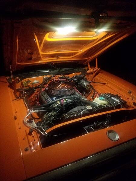

This has made working on the car so much easier. The set up is water proof, adhesive backed, 5630 led strip I bought off amazon to do my tail lights and some speaker wire run down the hood to the battery. Its cheap and way better and brighter than holding a flashlight.
Just a parts store SPST toggle switch I installed next to the battery. Power comes off the starter relay post. Nothing special.
