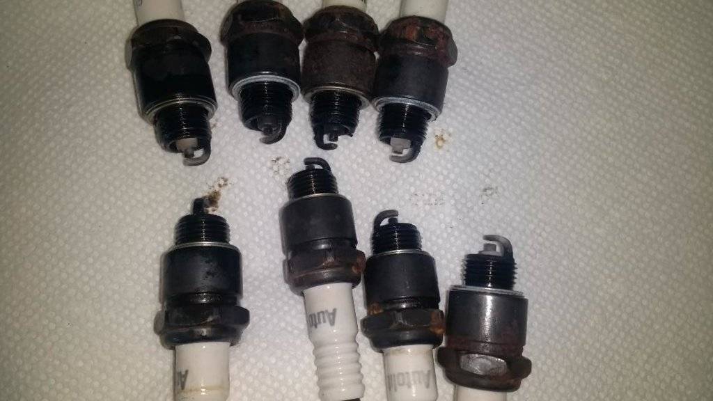

the short answer to this, "Is this typical of an engine before it is really broken in or an indicator of issues with the rebuilt?" , is no. now it's the process of elimination to find where and how it's going there. i would start at the plugs and go from there if it were me. what they look like will help give you a sense of direction for next.

I have attached a pic of the spark plugs.
