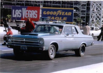

Stroke that 400 and you will be a happy man.Did a 451 on a dime budget.Even running Schumacher shorty headers and 4.10 gears this thing ran 11.90 at 110 mph.3600+ lbs in full street trim.Just my 2 cents...
Forgot to say it ran on pump gas 91.

To:DARTER6
What the heck is a dime budget these days ?

avidflyr,,,Whole project was just at $10,800.(AKA 10,dime.Old folks slang) Lots of used parts and a few freebee's .451 stroker complete and running $6250. That's 2004 prices.
