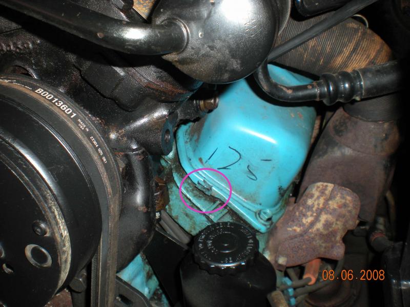

hi guys,
Does anyone know what kind of engine code was written on the valvecover of a 426 Max Wedge engine?
( I have attached a random engine pic from the internet, just as an example )
thanks!
Marcel

Depends. The assembly number changed year to year as well as between different versions of the MW. What year and which variation are we talking about? Do we know for a fact that a number was there on a MW?
Goodmorning,
I am cloning my car into a 1963 lightweight Max Wedge car; so with the hoodscoop. Original engine would have been a 13.5:1 compression.
As my car may look nice, it is a 100% clone. But i'd like to have it look as original as possible.
