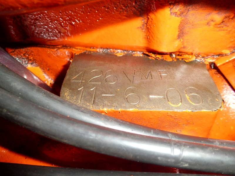

i traded on a 63 sport fury that has a 426 wedge stage 3 engine that is suppose to be a fresh rebuild and sounds great and i wanted to see if its truly a stage 3 max wedge the numbers stamped on the top front of block near the intake are 426 vmp and under those numbers 11 6 06....and also looking for the carb sinkronizer tool..

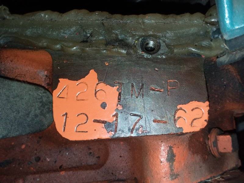

my engine is a 64..i know it isnt original to my car ..is my engine a stage 3 from 1964?

11-6-06 looks like somebody stamped date of rebuild on the pad. Do you have a picture of the pad?

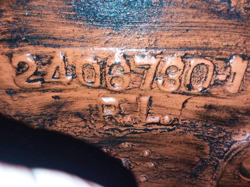

Stage 3 heads sitting on a 68 440 block, even with a stage 3 intake, wouldn't make it a stage 3. The block is the thing. Check your block casting number, passenger side , rear half of the block. One of the two numbers above, you have a max.

the valve covers are 6 bolt ..the intake casting numbers are 2402726-1 ..the numbers off the side of the block are 2406730 i am trying to get a good pic of the numbers on top of the block it has alot of paint on it..
