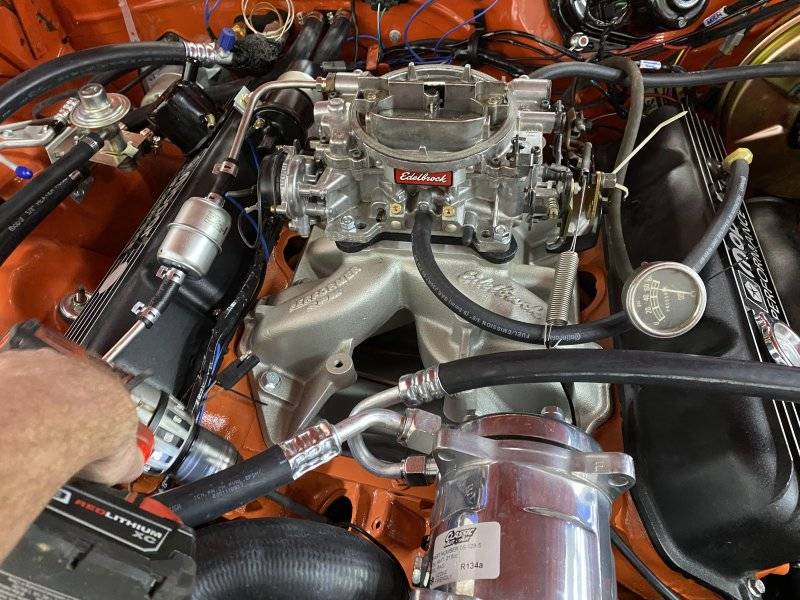

I did this: The #8 plug wire in the bottom slot, the next slot up left open for the wiring and the top slot for the coil wire to the coil mounted to the rear of the right cover. The clips are aluminum. I have to find another two slot clip for the rear set, hard to find, these are old, from the late 1970's. I may end up using a Dremel to MAKE a second slot in that rear single slot clip. I'll just have the Distributor wire and alternator single wire to go through there plus the choke from the other direction.

Run them like factory. I used very small zip ties to keep them in order.

Unusual application to measure the PCV vacuum with a 0-80 psi gauge.....vacuum is measured in inches of water (0-30" w.c) column.....I know the thread is dealing with wire routing......the gauge issue just jumped out....

That gauge is measuring oil pressure while I prime the oil pump with the drill you see in the pic. Your reading to much into the picture.

My bad.....apparently due to close proximity of the PCV hose, it looks as if the two are connected.....sorry...need to get my eyes checked...
