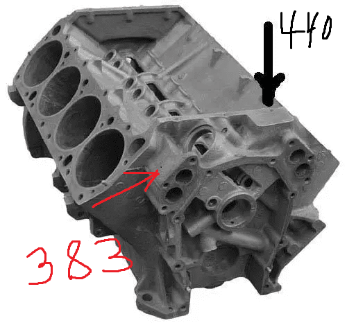

383 should be under the distributor. 413-440 front flat pad. The 383 should be on the passenger side. 440 right up front above the water pump housing.Where the black arrow points to the pad,it's flat.If it were slanted then it would be a 383.Some one correct me if I'm wrong...........
