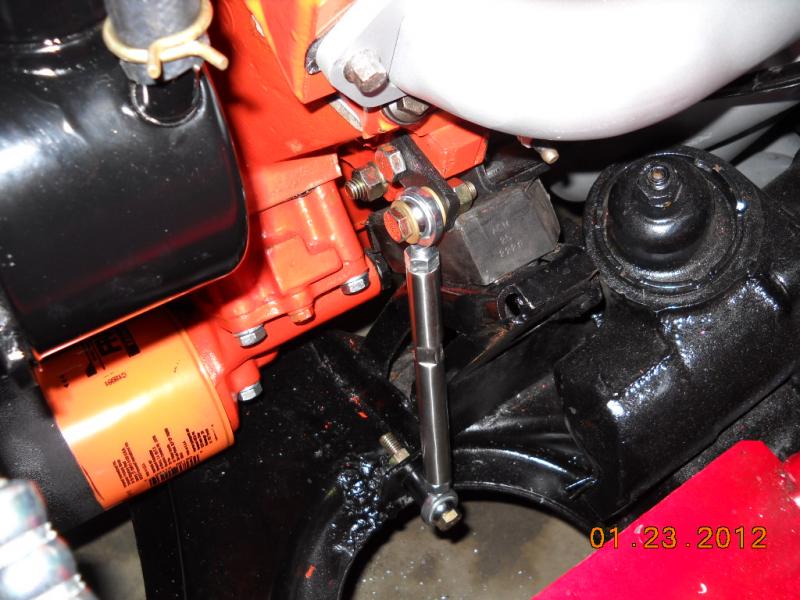

I've used hardware store aluminum turnbuckles with good results
Homemade from internally threaded aluminum and a couple of heim joints. Grade 8 hardware. This is my third car with a similar set-up and never a problem... I did run solid mounts on my race cars, but they transmitted too much vibration for my liking on my street car. To each his own...

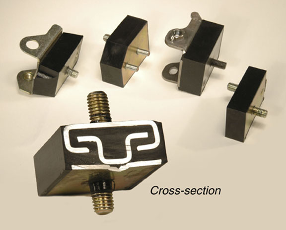

I like this idea, I built a shaker hood car with tight scoop to hood clearance and liked this because you can run the softer motor mounts keeping the vibes down and also control the motor movement. Schumacher makes a kit like this, I also like they're poly locks but have been told they rattle the car a bit more than the factory mounts???thCAIUS2UH.jpg

The sandwich Motor mounts are made in India and all suck. Get a few Clevis ends and make a Torque strap. If you want to get fancy add a small Shock absorber from a tractor and your going to have less problems.
