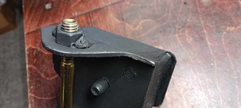

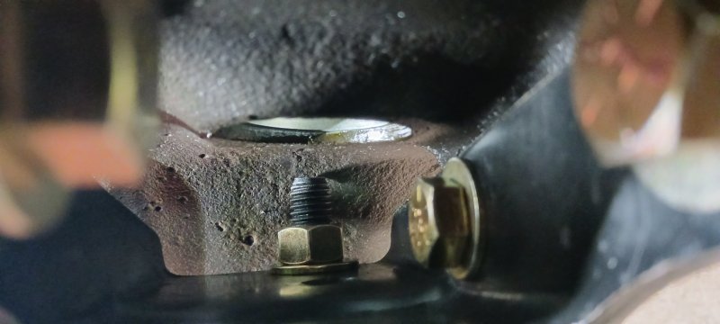

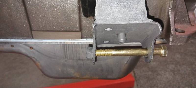

Then I did the recessed bolts and lock nuts trick for the bracket and engine mount for piece of mind on my Stroker Motor
