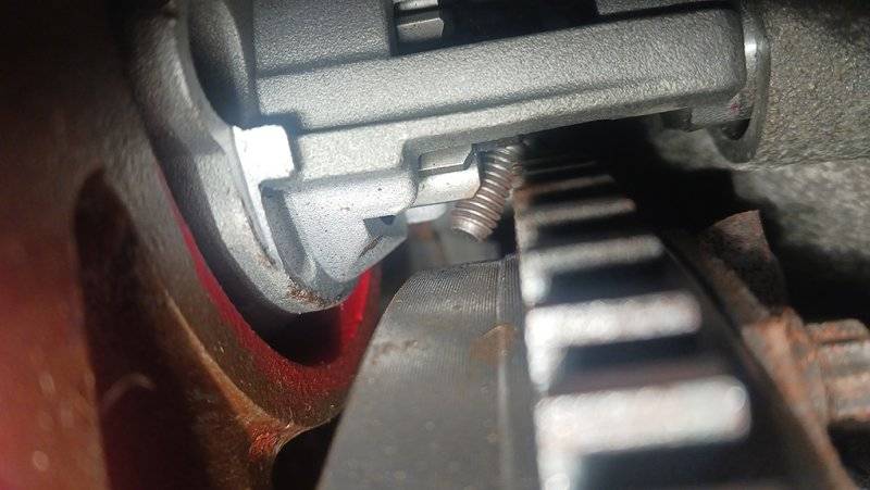

Hi folks,
Rebuilt 383 (4 speed a833) that rotated fine both directions but now that it is installed it will only rotate counter clockwise, like butter - if I try to go the other direction it just locks. I thought maybe it was in gear but no. I feel like it might have something to do with the transmission but it goes into all the gears and reverse fine. I have not run the engine since rebuild.
It’s in a 73 Duster.
Cheers
Ok... now a serious comment. What happens when you engage the starter motor ?
is a bolt from the torque converter hitting the transmission
Maybe the sheetmetal flywheel inspection cover is hitting the flywheel ?
Does it still lock with the clutch disengaged? Could the starter drive be engaged?
Can you turn engine more than 1 turn CCW. I wouldn't hit the starter until your sure you don't have some in a cylinder. A long flywheel bolt?
Oh man, this is a good one. Notice anything different in this photo?
