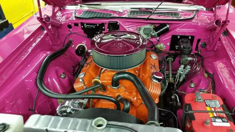

I use hemi orange from Eastwood. Ceramic paint used with activator. Like some stated, prep work is the key, I don’t use primer. 30,000 miles later and it still great with no flaking or peeling. Used the same stuff after motor rebuild. Downside, it’s a little glossy at first but many miles later, begins to dull. Painted two motors with this stuff last couple of month, lays out pretty nice. One qt with activator is 50 bucks, two motors later and still have paint left.

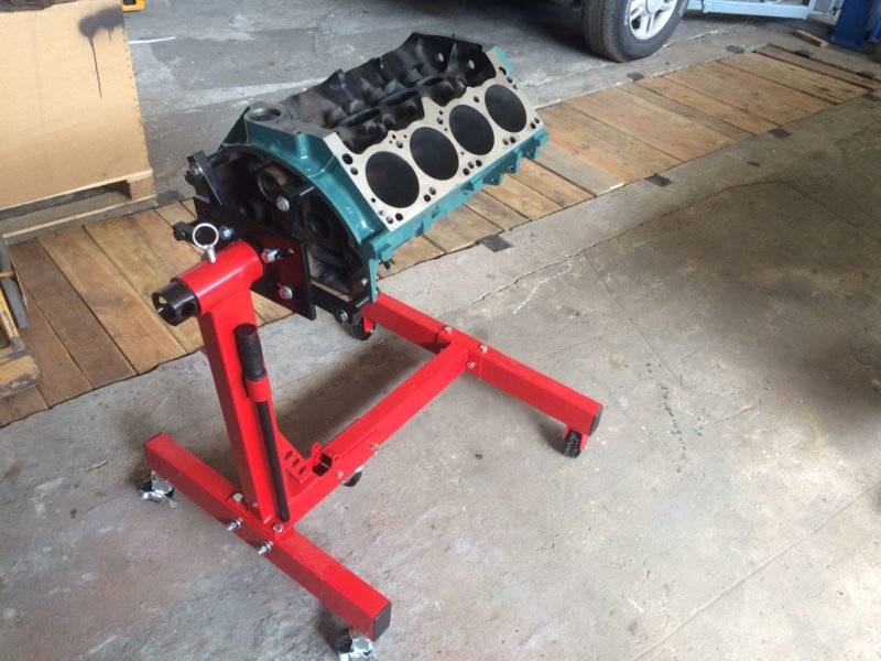

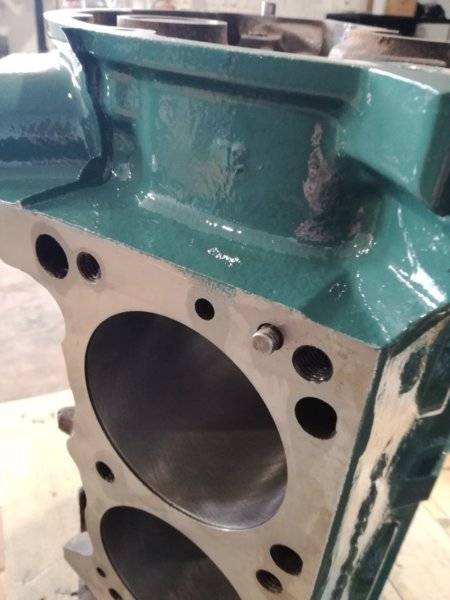

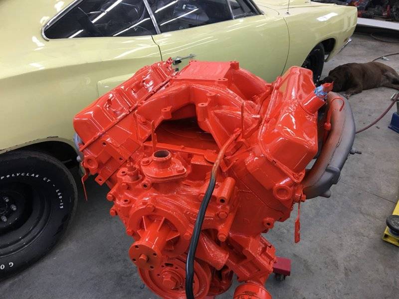

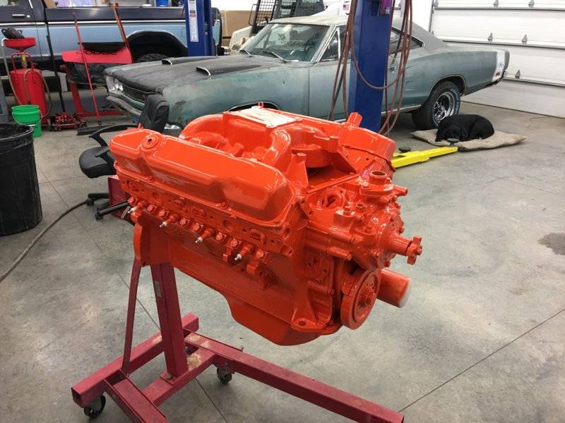

I agree in prep. DX 440 grease and wax remover followed quickly with clean dry rags until the second rag comes off clean. Knock off the sharp burrs with a grinder. We use DP 90 epoxy primer then single stage urethane. I have motors that have been painted many years . The small block pictured was painted 15 years ago, the big block 6 years ago.

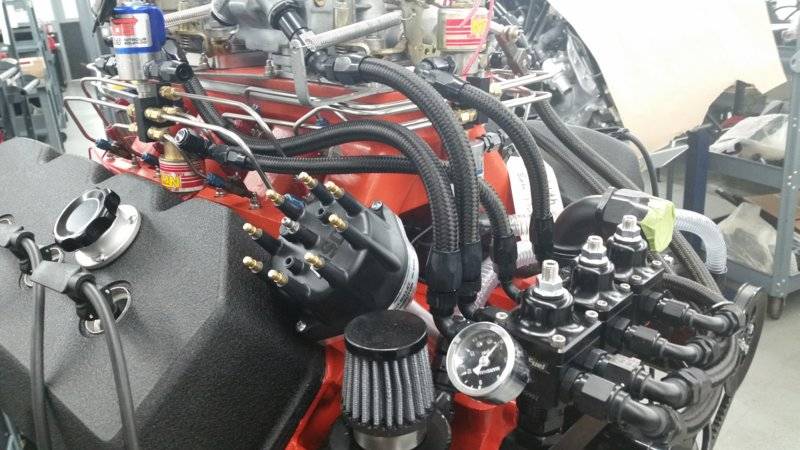

I just use a quick coat good Self etching primer. Then just use Duplicolor engine enamel paint cans on my engines. Even used Duplicolors wrinkle paint on my rocker covers & then baked it on with some infrared heat lamps with great results.
