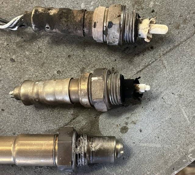

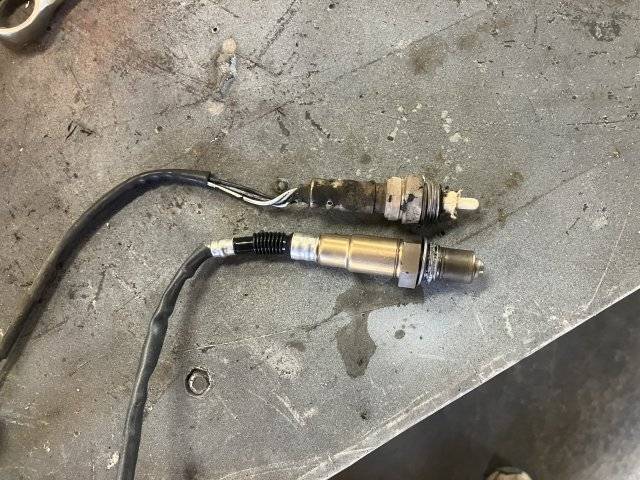

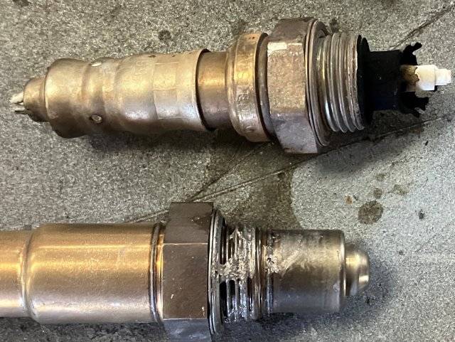

The upstream O2 sensors looked pretty crappy. Here is the LEFT side next to a new one.

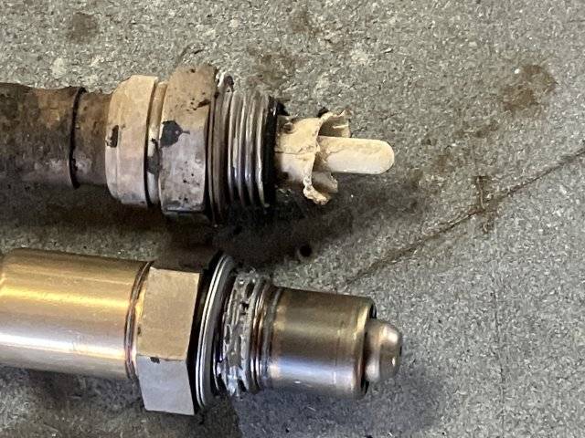

Closer.....
Note how the "barrel" at the end was blown apart and mushroomed. The white discoloration is strange too.
Now the right side:
Same condition of the "barrel" but the housing is sooty black, indicating a rich mixture going through.
Finally. original LEFT, RIGHT then a new one for comparison.
