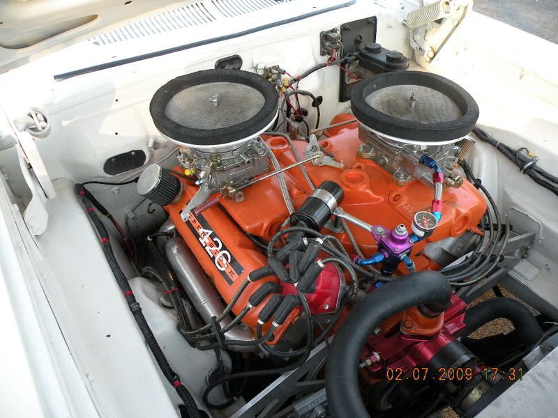

How can any Mopar fan not love this look on a 62 to 65 Mopar when the hood is popped ? Yes for performance I like the Indy intake but for pure coolness on a street driven car it dont get much cooler then this. Ron

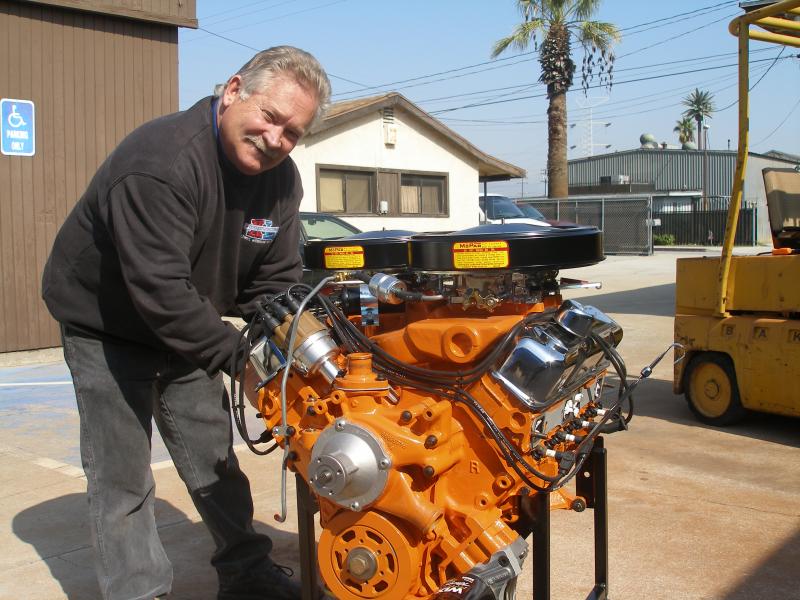

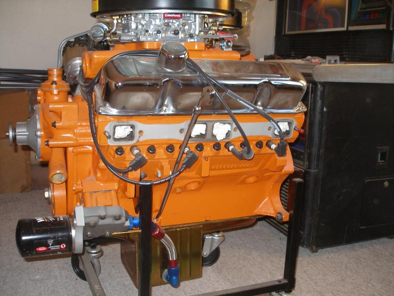

Here is my 440 based Max Wedge.
440 based Max Wedge

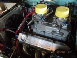

A&A manifold, carb linkage and set-up
TTI headers
All GOOd STUFF inside.
Eagla H-beams, Forged crank,
Custom pistons...
Assembled by Dale Reed, Baldwin Park, So Cal
This is Dale Reed, Ex NHRA Mopar drag racer...

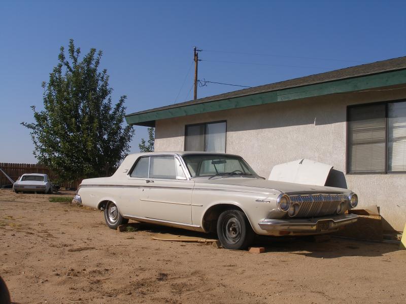

The car it is going in...does not look like this now.
