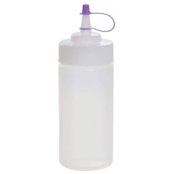

Try priming the float bowls through the vents with a plastic bottle before starting it. A good healthy 1/4 bottle squirt works great for me. If that helps, evaporation is most likely your problem.

It's the nature of the fuel blends we have today plus it does evaporate rather quickly because of it being a blend. My solution is to crank the motor a few times to get the fuel pump up to speed. I then use the ol' squirt bottle routine to get it to fire. Usually a couple of times before it consistently fires up. then get it up to op temp, put it in gear and away I go. As mentioned above, Carter/Brocks tend to have this problem more so. I am running a Demon square bore 750 cfm in my 66 with a 383 and I also have the same issue occurring so it is more the gas being what it is rather than the equipment...cr8crshr/Bill:usflag::usflag::usflag:.
