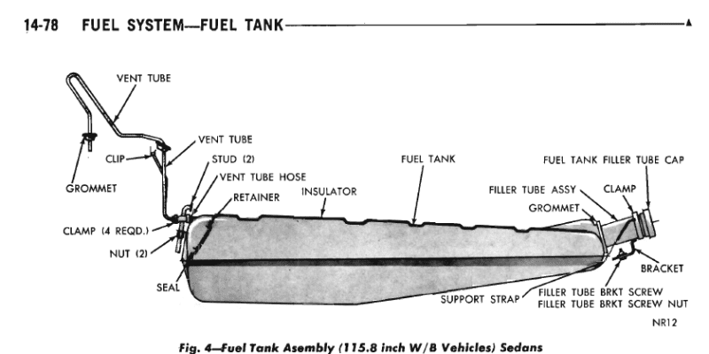

My 65 Sport Fury always seemed have a gas smell after driving it. I thought it was coming from the tank or vented gas cap and wafting from there but one day found it by accident. I could never find any drips of gas in the garage so never considered a real leak. One day after driving I had it idling in the driveway and noticed a drip on the ground under the fuel pump. A bit of research found the fuel pump fitting wet but only leaked at higher rpms. I tightened up the fitting and no longer have the smell. It don't take much of a leak to cause a stink so diligence is king. A strong odor points to a leak rather than a vapor.
