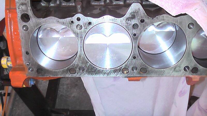

My 360 build should be ready this week.My question is what to do about the 318 that is coming out of my 71.I plan on pulling the 318 this October,and putting the 360 in mid winter.I have no room to store it in my garage, so I plan on putting her in a wood box outside.What should i do to protect her for maybe a long time.my 360 build if anyone is interested.full bottom rebuild, speed pro h116 cp piston,comp cam h 262 ,202 j heads, 650 dp holley, eledbrock rpm intake,2800 stall,rear gear no sure yet. thanks for your thoughts.
