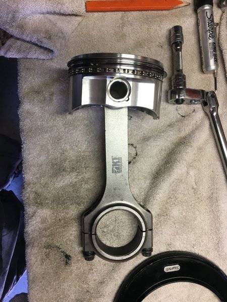

I'm running a 272/278 @ 0.050" @110 LC, 0.726"/0.726" lift with 1.6:1 rockers. Piston to valve clearance is getting tight with the 4.150" stroker crank in the 400 block with the Icon flat top pistons, so can't easely do a larger cam, and likely wouldn't be be any quicker in my heavy 4,200 lb car.
If you want max performance, no reason to not stroke the engine for more displacement. The strength upgrade of the 4340 crank and rods, plus 7/16" rod cap screws is worth it, plus makes the piston weight much less, so 7,000+ RPM is alot safer. I have the BCR aluminum main caps and 1/2" girdle, on a thick web 240 cast 400 block. I don't know how much it helps, but there is not much more you can do to strengthen the block. The oil holes have been enlarged, oil pump ported, 1/2" custom internal oil pickup. No vacuum pump or evac, just using the Icon pistons with the standard Total seal 1/16" ring pack. Next upgrade likely use the radial ported piston rings, or a piston with thinner ring package (or combination of both.)

Stroke it to 451, 3.9” stroke, 6.7” BBC rods, way lighter reciprocating weight. You could do this with an offset ground 440 crank. These flat top Diamonds produced 11:1 compression at 84cc, 78cc trick flows should get you closer to 12:1. IIRC, this setup saves over a pound per cylinder over stock rods and TR dubs. With a good oiling system and appropriate valvetrain, 7000+ should be doable no problem
