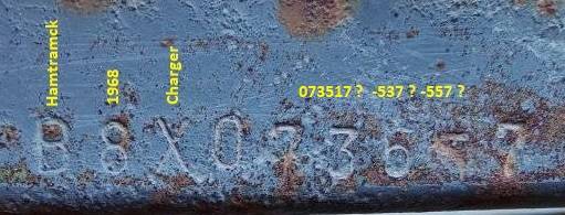

Establishing a VIN number from the order number on radiator core support

66-70 were XS29.
You're correct, not all Chargers were the S special price class. Just using mine as an example along with the 29 designation.
Yep no such thing as an XS charger before 68.
And then a few XS and XX after that until 70 they brought in an XH
But the vast majority were the original XP.

Does your VIN start with XS29L8B?
Strictly a guess, but it seems likely. Lack of a sway bar is odd... any tabs on the Lower Control Arms?
Start checking date codes stamped into K-member and body panels to try to narrow down the vintage? Order number is little help since it can span the entire 101 to C31 calendar. A few members on here have a veritble boatload of Broadcasts collected that might help with bracketing in conjunction with this car's date codes? Without a broadcast, back tracing ownership is probably the only way to ever determine with accuracy - we can only surmise and speculate.

If we are anywhere close, you could contact Barry at Hamtramck Historical as there are a few potential sources on file there to check. (couple clinkers, too)
HH contact page link
He's probably a B-bodies member, but I only know his handle on A-bodies, so I can't tag him here.
Don't get your hopes up, tho - you are trying a nearly vertical uphill endeavor!
